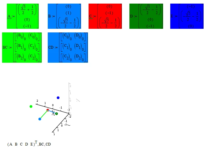

Hi, Everyone.
From the following:
The Question 1: How to Rotate A around BC-axis with angle t ?
The Question 2: How to Rotate B around CD-axis with angle t ?
Thanks in advance for your time and help.
Best Regards.
Loi.

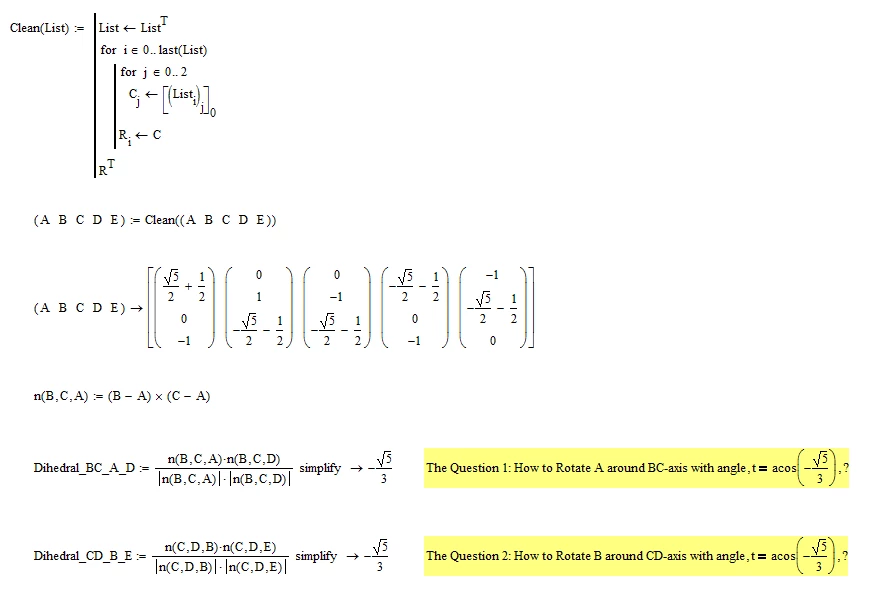

I'd suggest using homogenous coordinates (quaternions) as with them you can describe a translation by a multiplication with a matrix.
lvl10720-TurquoiseAuthor
20-Turquoise
Oct 21, 2022 12:39 AM UTC

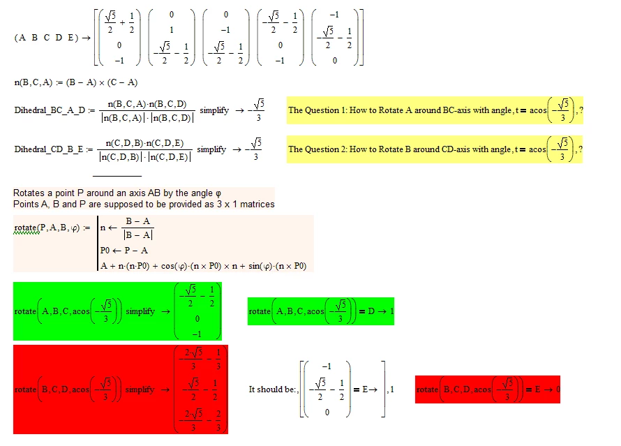

   Many thanks, Ppal amd Werner. The following: the question 1 was solved.
Best Regards.
Loi.
terryhendicott
Oct 21, 2022 2:13 AM UTC
Here is a file from earlier on the community.
It has a function that uses quaternions to do the rotation.
