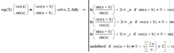

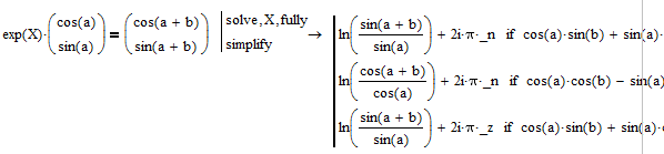

See the attached.
April 6, 2014
b=0 is not the only solution here, rather can b be any integer multiple of pi.
In Mathcad's solution a could be any complex value, but IMO we have to exclude integer miltiples of pi/2 which would make one of the denominators to zero.
So the solutions for X are either k*j*2*pi (including X=0) and (2k+1)*j*pi, where k is any integer.
We can also use
or
and try to encypher Mathcad's case distinctions.
