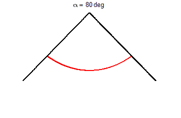

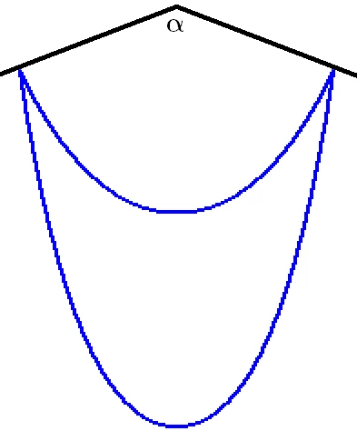

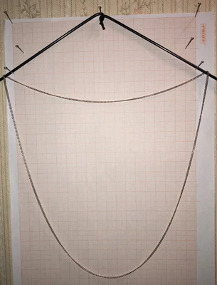

and on one... corner.

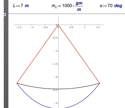

Can you determine (numerical or symbolical - better with Mathcad and without friction) the critical value of the alpha angle when the chain falls off the corner?

One try of solution in attach! But I am not sure - is it correct!
June 11, 2018
I feel it is a solution - a numerical solution. Check please Mathcad 15 sheet in attach.
anim2.gifI am waiting for one symbolical solution. What is it 108-109 deg?
