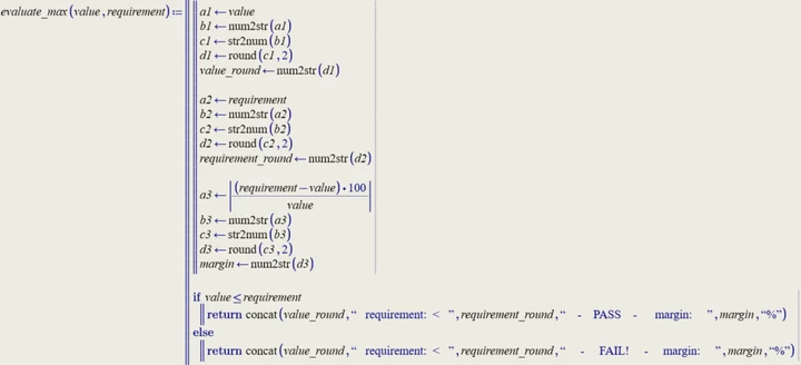

hello,
im trying to get best wey to round numbers with units like 5.123456789 V
im using the function round(x)
but shows error for units not compatible
need to use the rounded value to show on summary results
right now im using this functions to round and display the results
 but this basically remove the units and convert my variable over and over to number and string, to be able to display it as result.
as you can see below
but i want to show that result is actually 3.33 V
I also have calculations for current, and capacitance, so I need function to keep different used units.

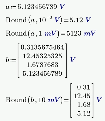

Werner_EAnswer
Feb 29, 2024 9:15 PM UTC
For quantities with units you have to use  the "Round ( )" function - note the capital "R"
Syntax is different compared to the "round()" function - look it up in the help.
The second argument is not the number of decimals but with "Round" you round to multiples of the second argument. So 10^-2 V rounds multiples of 10 mV which is equivalent to two decimals in Volt.
See: Truncation and Rounding Functions
