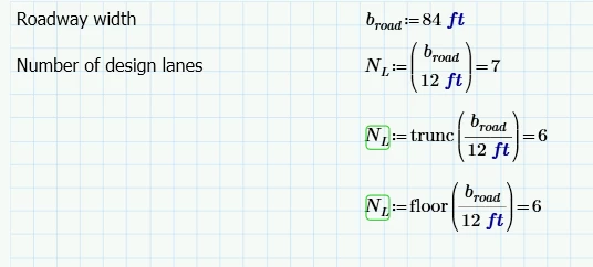

I'm having an issue where I need to do division, then eliminate the decimal portion of the answer and only keep the integer. I've successfully used both trunc() and floor() for this application in the past. But when the quotient results in an exact integer (like 84/12=7 in my example), Mathcad rounds down to 6 instead of returning 7. I'm assuming this is the result of some approximation internal to how Mathcad does division. Like it's really calculating 6.99999999999999... maybe? Are there any work arounds for this? Obviously I can just make the equation 84/12, but this is in a template that I'm trying to make apply to all cases.

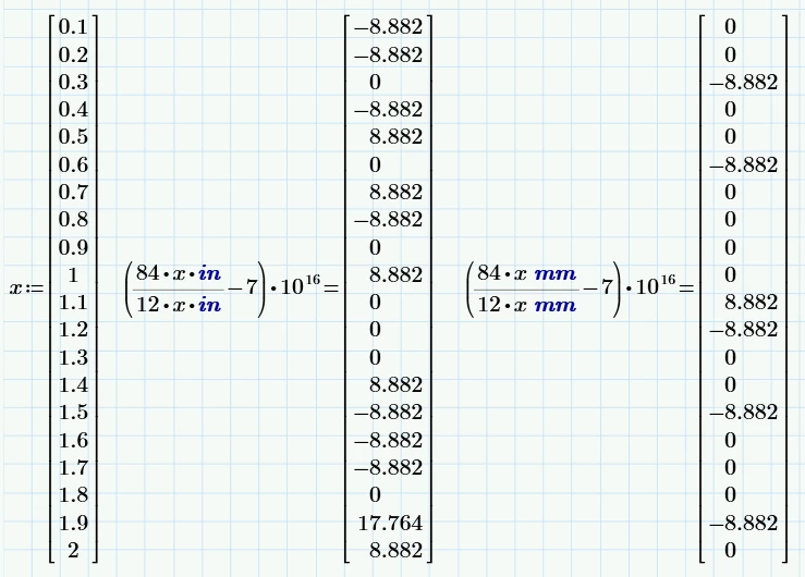

Yes, the problem is because of numerical round offs - especially because of the usage of non SI standard unit (Prime stores values with SI units no matter how they are defined)

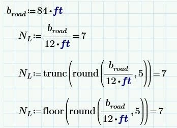

You may either add a small percentage to the nominator first

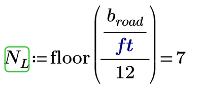

or get rid of the units by dividing b.road by the unit feet

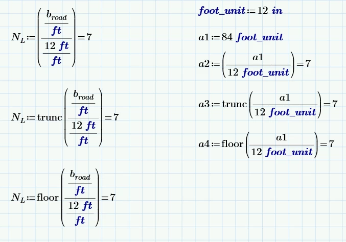

it seems to me that the problem is related to ft unit somehow (I do not understand why).
In Mathcad Prime 9.0 following notation works well.

Here is another way
