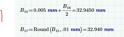

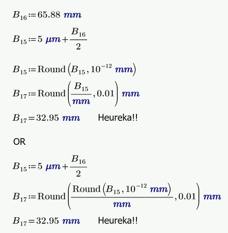

I am hoping you can help.
As you can see below, I would like B17 to be 32.95, as if B15 is 0.005 and above, it should round up. And if it is 0.004 and below, it should round down.
you can

Its hard to impossible to debug just a picture!
Possible explanation: The value of B15 might be something like 32.94496321... mm and because you set Prime to display four decimals, the correct display would be 32.9450 mm. The correct value rounded to the nearest hundredth mm would be 32.94 mm.
For further help you would have to attach your worksheet, not just a picture.

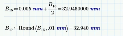

Thank you for the reply, the sheet is part of many sheets that form our design intent, so unfortunately cannot share the sheet.
By changing the d.p.  It still is incorrect, as round up to 2 dp should be 32.95

B15 still could be 32.949999999999999999999999999999123 because of round-off errors of prior calculations or because of length unit conversions.
Can't say more without seeing the data.
You can try to isolate the problem somehow and create a new demo worksheet just showing the error and not the sensible data.

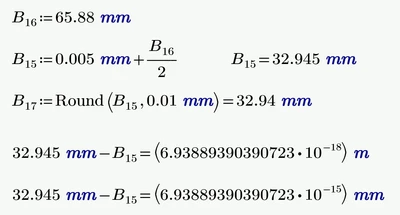

What do you get if you evaluate 32.945 mm - B15 = ?
EDIT: OK, tried it myself and could duplicate the error.
As you can see, B15 is slightly smaller than 32.945 mm (about -7*10^-15 mm).

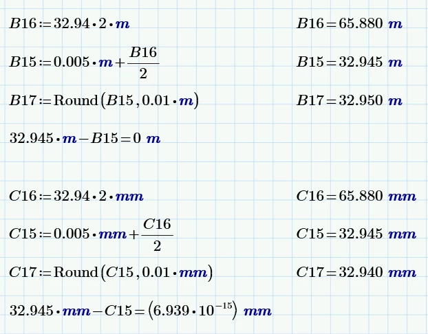

Reason seems to be round-off errors due to Primes internal unit conversions, because all is OK if I remove the units or if I use m instead of mm.

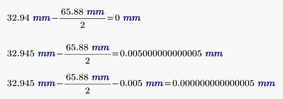

Actual problem seem to be the adding of the 5 um as you can see here:
You may report the problem to PTC support but I guess that numerical round-offs can hardly be fixed without opening new bugs.
Seems that you have to find a workaround which fits for your application. Maybe some kind of "double rounding".
EDIT 2: Rounding twice (B15 to 12 decimals and then what you did for B17) does not work because we run into similar problem when we use the rounding function:
Workaround could be to strip the units and add them again later:
So a possible (sure not desirable) workaround for your case may be:
If you decide to go into the troubles of contacting PTC support, let us know the outcome, please.

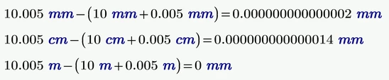

Here some simpler examples of the same problem:
May 10, 2024 11:00 AM UTC
it seems to me that the problem is related to unit conversion.
SI unit system uses m as default and you are converting m to mm.
May 10, 2024 11:29 AM UTC
Correct!
Actually, as shown above, that kind of error occurs twice in the given example.
The first time, when the 0.005 mm are added and then again when the "Round" function is used with 0.01mm as second argument.
Its hard to deal with that kind of error and the solution depends on the specific application. My 'solution' above sure is not a general solution for all situations 😞
