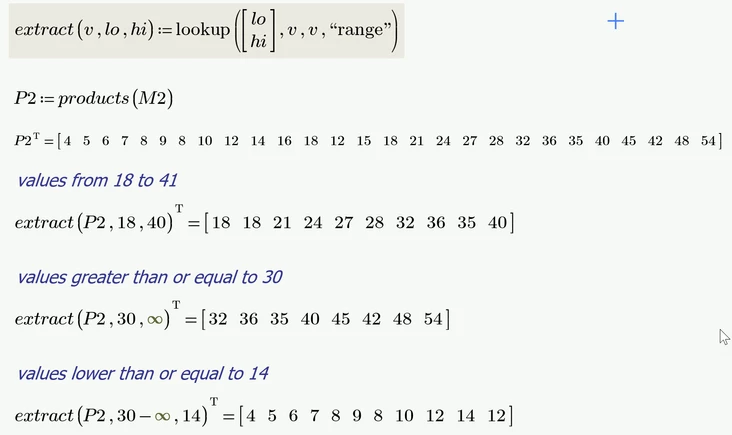

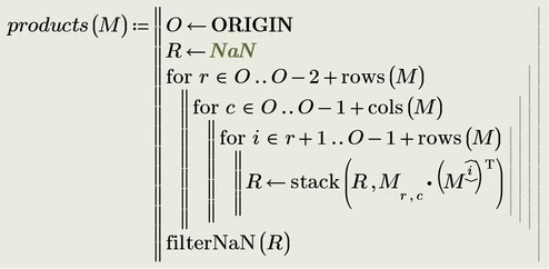

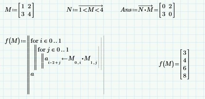

Can I get some help how to how to write a function that return all row products in a matrice according example below?
Second question is how I extract data lower, between or higher then a given number.

Hi
Like this

8-Gravel
Jul 26, 2024 2:49 PM UTC
Ok, thank you so much for this!
I manage to add more columns to your function. But I don´t manage to add more rows?
Help please 🙄

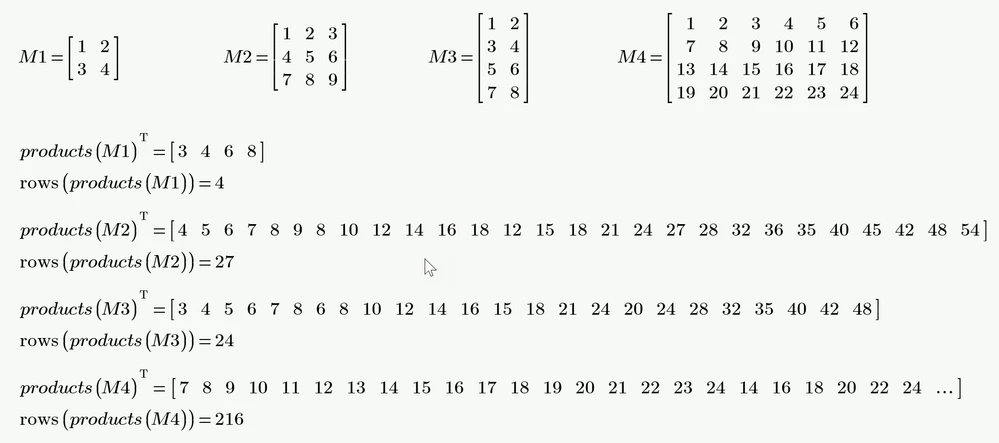

terryhendicott
Jul 26, 2024 4:47 PM UTC
How your function works on more rows is not easy to follow.  You need to provide an example of what happens with three columns and three rows?

Jul 26, 2024 6:17 PM UTC
You are very unclear when it comes to describing what the function you ask for should actually do if the matrix has more than two rows.
So we can just poke in the dark ... 😞
Maybe this function is what you are looking for:
Its also not clear which way you would like to "extract" values within a certain range. I assume we are talking about filtering and trimming a vector.
You can make use of the built-in "lookup" function to do so:
