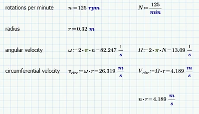

even though a direct conversion is not possible as these are two different kinetic properties, you can calculate the circumferential velocity; see attached sheet in MCP 9

Hmm,
in Prime rpm is different from 1/min.
Jan 24, 2024 10:14 AM UTC
Hello Martin,
thank you for bringing it to my attention. That does make a difference
regards
Raiko

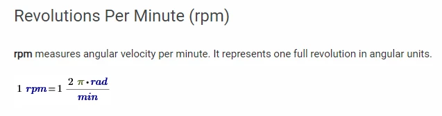

Jan 23, 2024 5:03 PM UTC
https://community.ptc.com/t5/Mathcad/rpm-frequency-unit/td-p/285769
There are two types of dashboards of cars:
  • with rpm as radian per min for Mathcad users
  • with rpm as revolution per min for others normal people.
https://support.ptc.com/help/mathcad/r9.0/en/index.html#page/PTC_Mathcad_Help/frequency_and_angular_velocity_units.html
