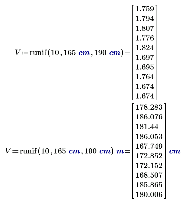

I see no reason why random numbers should 'have to be unitless by default'...
If I want to define a set of random lengths, I'd like to be able to define them directly (Valery's method) rather than through a clumsy method. I think the present present implementation should be corrected in that sense, considring that the units in the arguments are accepted.
So, if the user provides (consistent) units for the arguments of the runif function, the result should have (the proper) units.

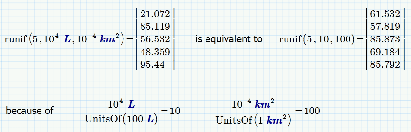

Random numbers have to be unitless by default. To achieve this, Prime automatically divides the arguments by UnitsOf(..). This explains the effects you are experiencing.
Prime's help does not promise, that runif will return values with units.
So the correct way of doing it is V:=runif(10, 165,190) cm.
Its not clear to me why Prime accepts arguments with units anyway (Mathcad consequently throws an error).
Prime's help clearly states that that the syntax is runif(m,a,b) and that a and b are real numbers (a <b). So you can't call it a bug unless you want to call it a bug that prime accepts units and repairs that user error by its division by UnitsOf(..).
In Prime you may even mix different dimensions, which does not make any sense at all.

The reason simply is that this is what the help (the only "documentation" we have in Prime) implies.
Thats a legitimate feature request and I have tons more of them. 😉
All I said was, that the behavior Valery is experiencing is consistent with the "docs" (aka help). So it can't be considered a bug. Its as it was intended - arguments to runif should be reals and that means no units. The problem arises because Prime (on contrary to Mathcad) accepts units and so we tend to expect units in the result. Prime should rather either throw an error or, as a new feature, work as expected.
