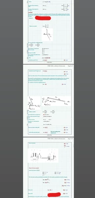

May 21, 2024 1:32 AM UTC
This is part of the solution, but not the critical part of
it. I need to run it by putting in a variable from the spreadsheet where the top red mark is, add it to a vector and process it to get a number at the bottom.
So while I can use read excel to get one variable through to get 1 answer, I need it to return to the top, get the next variable and run that one through as well, obviously continuing till I run out of data.

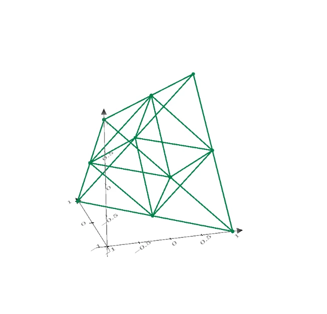

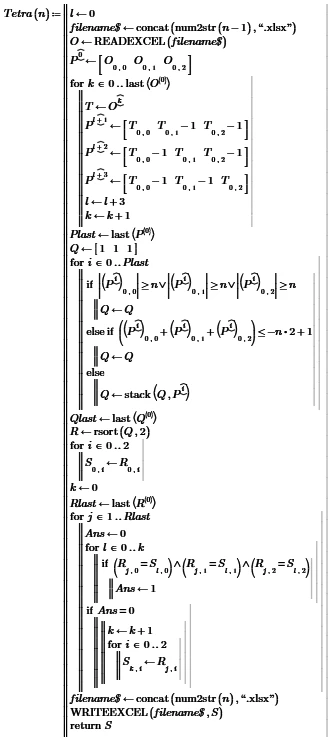

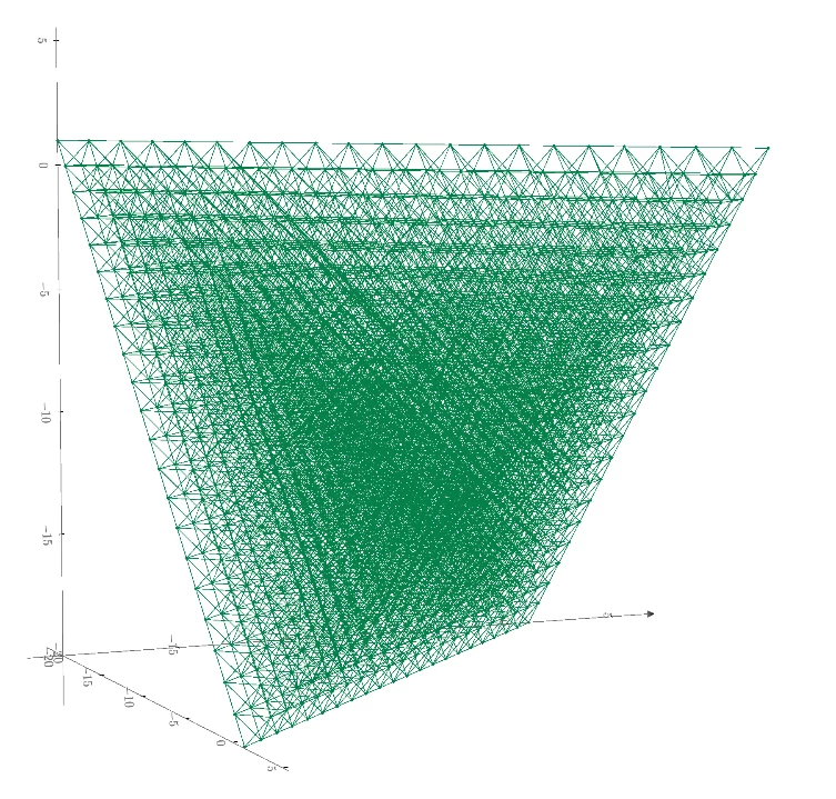

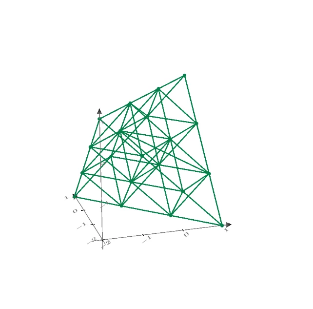

May 21, 2024 5:53 AM UTC
Using READEXCEL and WRITEEXCEL I made tetrahedron plots. At first READEXCEL read original tetrahedron 1.xlsx. Then made and write 2.xlsx file. Thereafter program continue the sequence.
You must make unique names for each excel file and read and write it sequencially.
