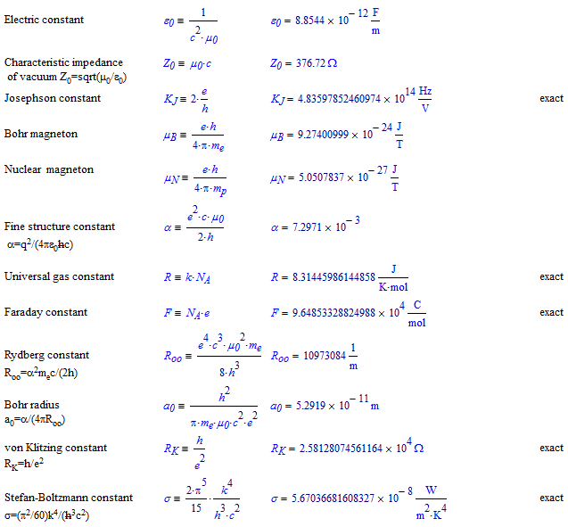

I apologize, I did some confusion ...
I would be very grateful if you find any imperfections in the previous list. Thank you very much

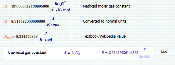

I mistakenly called the perfect gas constant, R, with the name of another constant, that is, Rydberg. Also, while Prime supplies the correct R value (constant of perfect gases) (written with the label constant). This does not happen in mathcad 15, ie when writing R = mathcad provides a temperature.
May 25, 2017
So I'd never noticed R was built-in before this thread, and had always defined it myself.  So I did a little comparison and found something interesting. The mathcad (Prime 3.1) R value does not appear to be correct.
