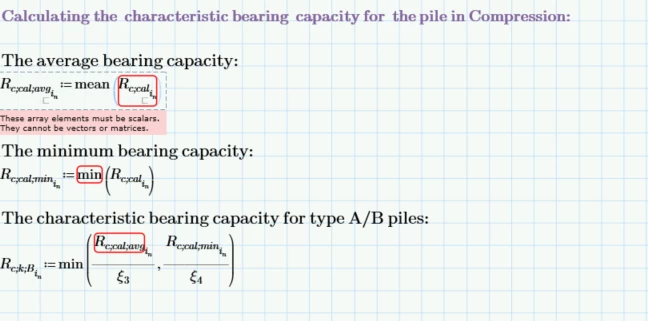

This really puts our clairvoyant abilities to the test! Without seeing the data in the argument vector R.c;cal, we can only assume that Prime is correct about the error message and that at least one element in the vector R.c;cal is not a scalar, but is itself a vector or even a string.
Maybe  R.c;cal is a nested vector like a 1x1 matrix consisting of a nx1 vector?
You must have a close look at the argument R.c;cal and find out, what its structure is and why its not a simple vector of scalars as it should be.
