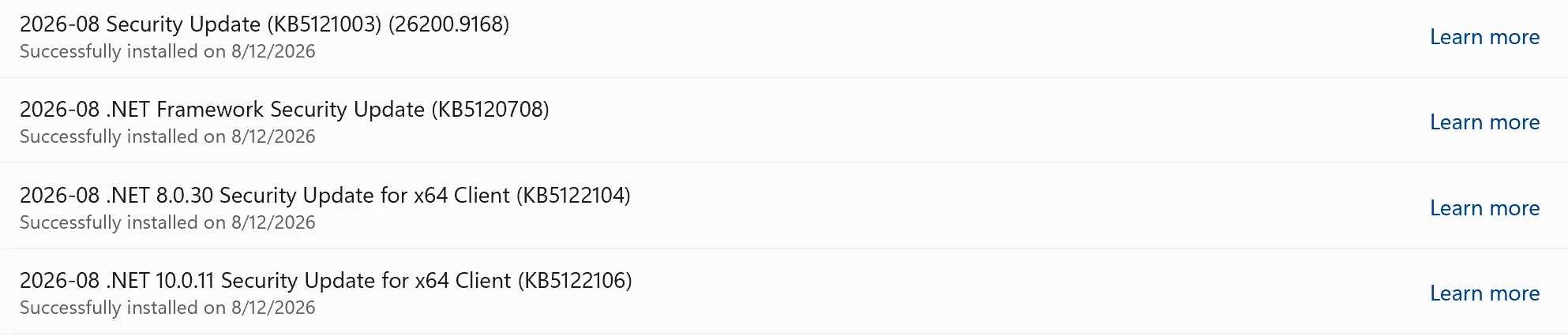

Same issue here at all licensed stations (Mcad version 11, 11-01 and 12.0) with Windows 11 Pro (USA); printing to local printers not working at all and printing nor save as PDF (results in an error message). Security updates were installed on 8/12. Any other suggestions?

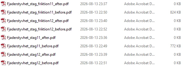

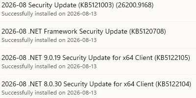

23-Emerald V
Aug 13, 2026 9:47 PM UTC
I can confirm.
With Prime 11 and 12.0.0.1, both express edition, before and after updating windows with the following set:
There is no error message, but the resulting file sizes (printing to “Microsoft print to pdf”) speak for themselves:

By uninstalling the windows updates (dated 8/12) listed on my previous reply, the issue was resolved. I have a ticket with technical support. I’ll follow-up once we have their response.
