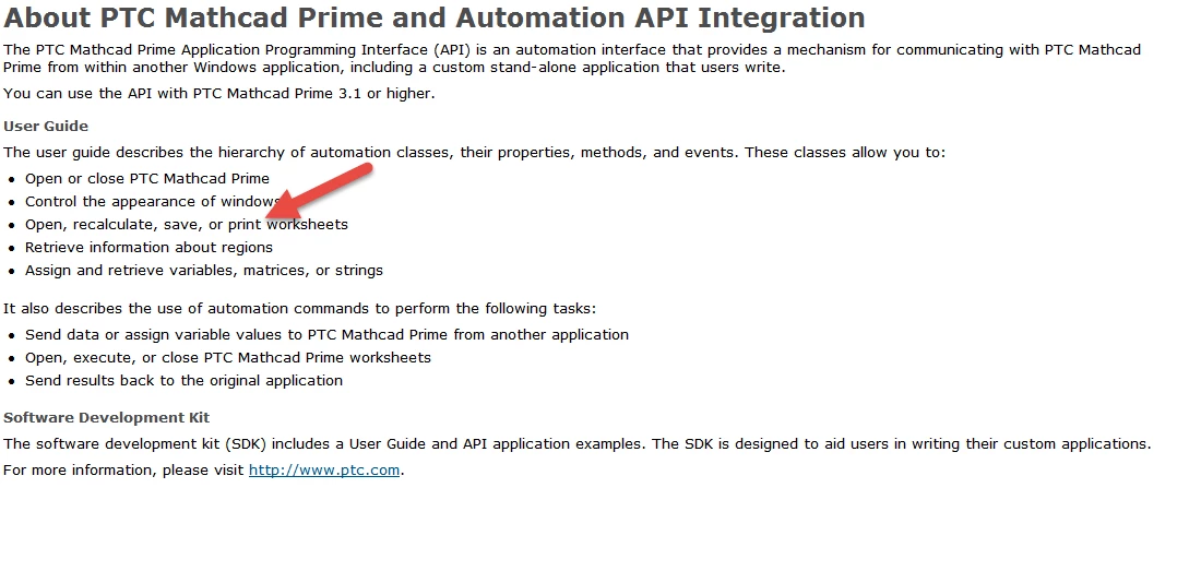

March 28, 2018
Contrary to PTC's documentation, the API doesn't allow to print to any format, correct? PTC should probably go ahead and remove that lie.
November 17, 2018
Yep, all the sdk documentation for prime API from 4.0 to 5.0 claims you can print from the API.
Ridiculous, the people writing the api don’t even know what the limitations of the api is they are coding and documenting.
It is still being advertised as automating printing of documents . There is not print method exposed in the api.
A 4.0 to a 5.0 is a major release and there is zero improvement in the API
