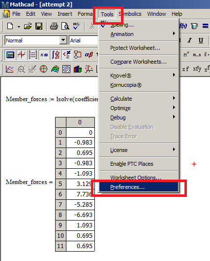

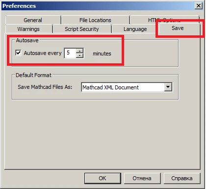

I can advise you the following:
* Enable "Autosave" option of the working file after a certain time interval (in main menu select "Tools" -> "Preferences" -> "Save").
