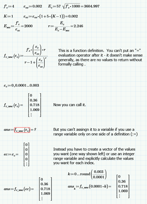

I am trying to plot fc_unc as a function of epsilonc, but mathcad keeps telling me tha epsilonc is undefined.
October 26, 2015
Since you're defining a function, try omitting the evaluation equal sign at the end.
