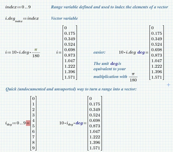

Guess you should learn the difference between a range (what you defined i .deg to be) and a vector (what you actually expected i.deg to be).
Ranges should be used in three cases only: 1) to index the element of a vector or matrix 2) define the plot range in a 2D-plot 3) in a for-loop when you use programming
