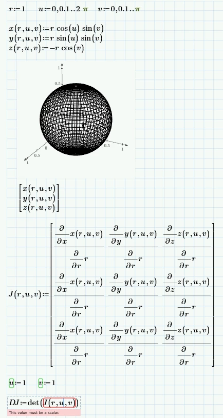

Hi everyone.
Im trying to calculate the det of the Jacobian however i keep getting this error.
Just what exactly does "scalar value" mean in mathcad? And more importantly, what can i assign u and v to fix this?
In my problem both u ∈ [0,2π] and v ∈ [0,π] but i dont know how to assign these values in mathcad.

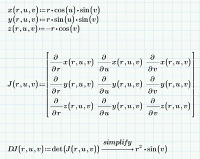

Then see this, its your initial Mathcad file. Nothing I changed. You defined in a wrong way the Jacobian matrix...

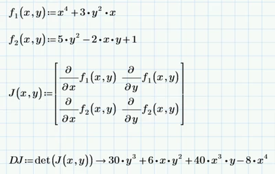

Post your Mathcad file...
Here is an example:
Jan 19, 2024 2:43 PM UTC
Here it is.
