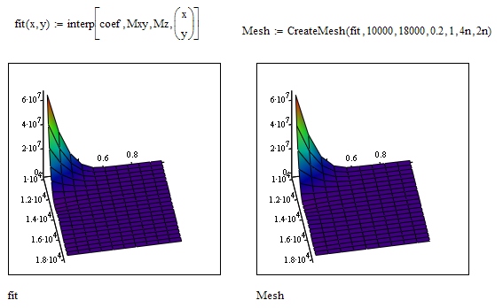

Hi Enrico Belmonte,
You have simply to remake the 3d plot, as I have done:
Saluti
FM

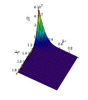

March 3, 2017
It seems to me that it's okay!?!?

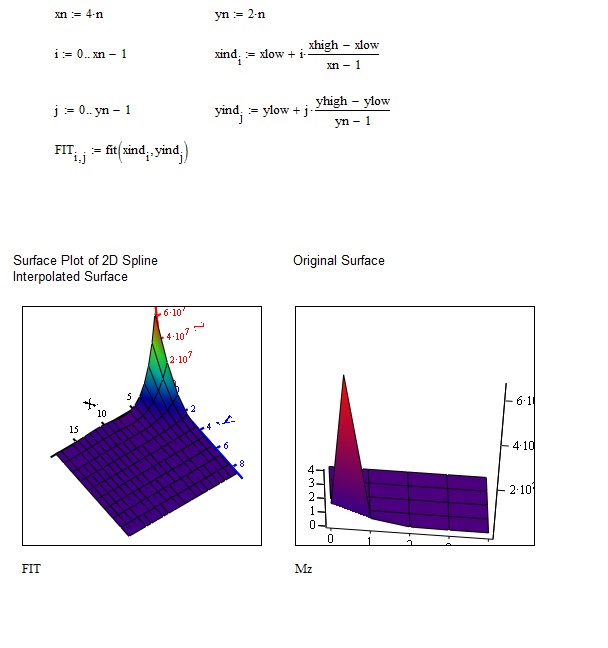

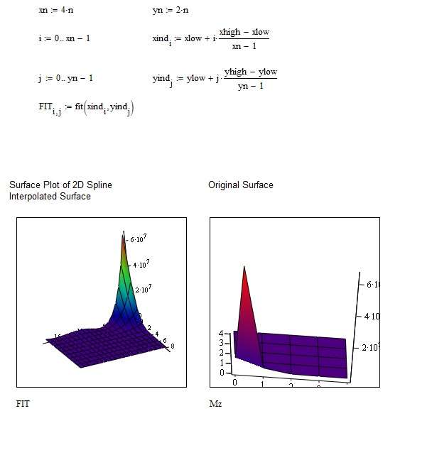

Furhermore, you can use the following program for a more accurate plot, but with the condition that the input matrix be a square one:
Example of "fitfield" use, plotting the function f(x,y)=sin(x)*sin(y)/(xy)

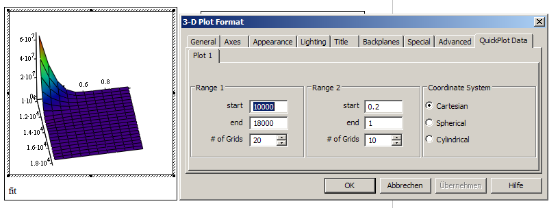

March 3, 2017
  1. As you can see in the attached file, I cannot display the x-axis in the right way.
Guess its easier than you think:
Using the first method (directly plotting the fit function) you would have to provide the ranges for x and y and also the number of grid in the "3D-Plot Format" window in the "Quickplot" tab.
So generally using Createmesh provides more flexibility and usually is the preferred method.
