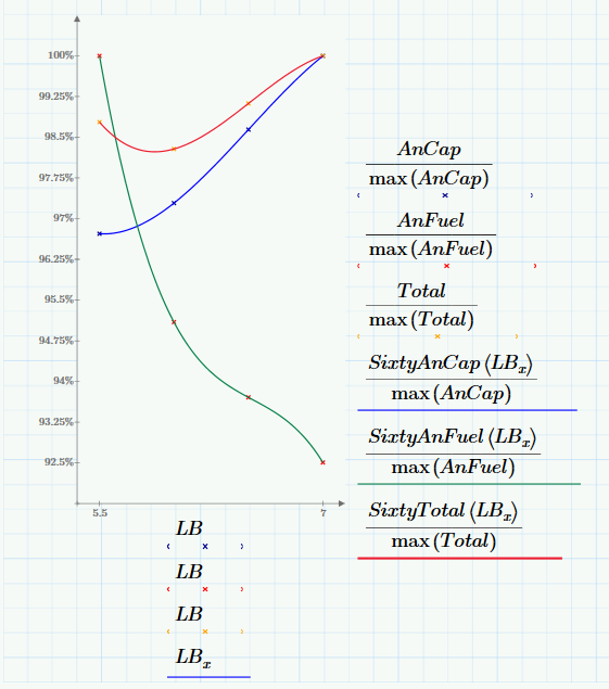

I am doing some cost analysis in the attached sheet. I want to show visually the shapes of the three curves which if I plot each separately is easy to do. However, because the scales are so different I am struggling to find a way to show the shapes of the curves visually on one plot as they appear as straight lines when plotted together. Any tips?

You might turn them into percentages:

‌Fred,
that hat is a really interesting approach I had not thought of what so ever. I'll be sure to use this for illustration in addition to actual values. Any thought on getting a better illustration with actual values?

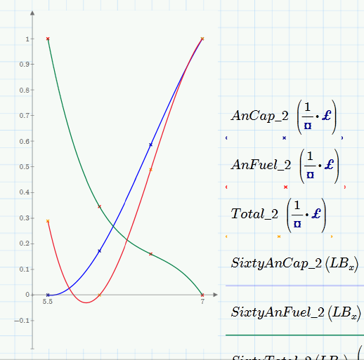

As Prime does not support more than one ordinate axis the only other way to achieve what you are striving for seems to leave it at a couple of separate plots side by side.
May 24, 2017 9:34 PM UTC
Peronally I would prefer three separate plots or Freds approach.
But for whatever it may be worth here is a scaling which forces all values (only the arrays) in the range from 0 to 1.
The scale on the y-axis is rather meaningless that way, though.
Yes! It is better!
Some of my students try to search any Physical meaning in crossings of curves.
