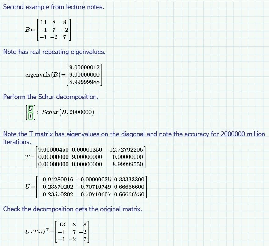

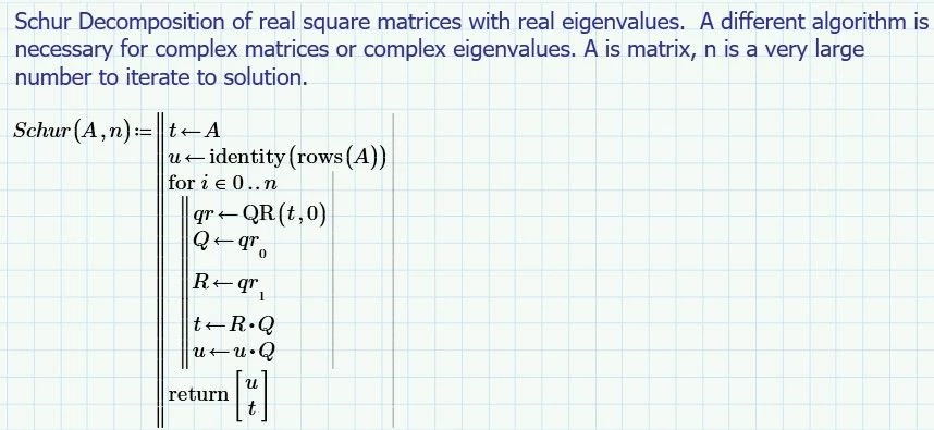

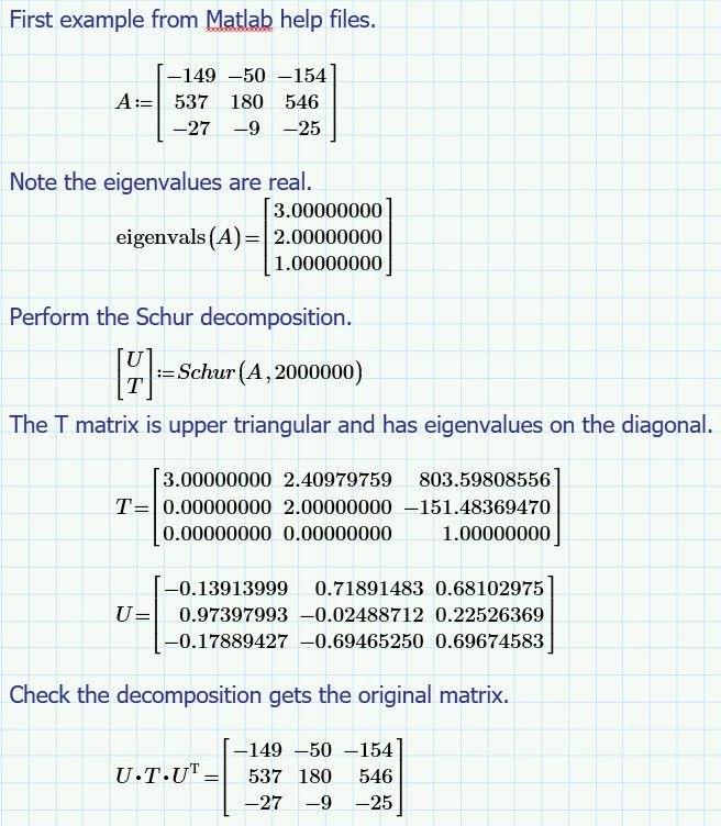

Hi Larry,
Here is the Schur decomposition for real matrix and real eigenvalues, have not developed the complex number algorithm yet.
Following are two examples from different sources.
Cheers
Terry

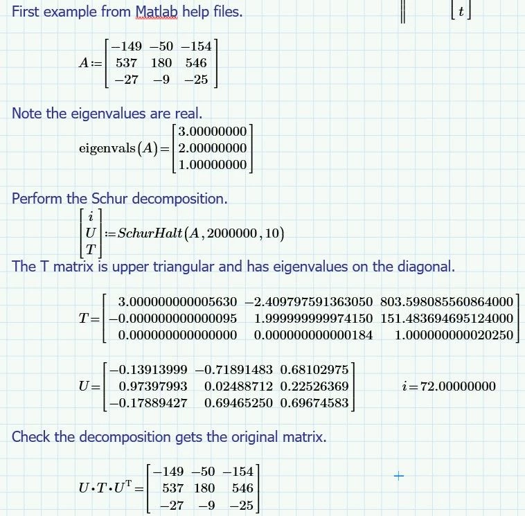

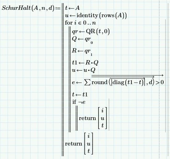

May 1, 2023 4:53 AM UTC
Realize the iterative solution often needs far less than 2 million iterations.
Here is a solution that defines the maximum number of iterations "n" and an accuracy in decimal places "d"
Cheers
Terry
