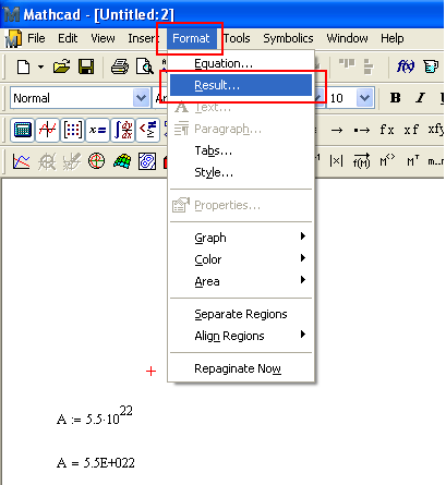

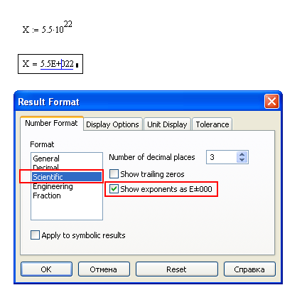

Bill,
Double click on result and choose:
Or you can set the default settings before you start work in the Mathcad worksheet. In main Mathcad menu select "Format" -> "Result":

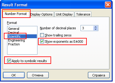

Jan 4, 2012 8:23 PM UTC
Exactly. But we can use the following:

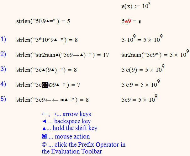

A Glaun wrote:
Agreed, no reason why Mathcad does not allow the 1E6 type entry. But.....
Have fun.
With prefix operator
Oct 12, 2013 2:45 PM UTC
Hmm, the main point of Bill's post 21 months ago was, that he accused the 10^x notation of being wasted keystrokes compared to the old Fortran notation. He counted 4 additional key strokes, in a later post he counted even 5. He counted the shift key as well but nevertheless in my count there are just three additional keystrokes necessary - I get the "^" without shift but have to use shift to get the "=", "(" and ")" - this may be different with other countries keyboard layouts.
Its a price am eagerly willing to pay for a more natural, mathematical, better readable notation.
Nevertheless I agree that Mathcad should support easy use of the Fortran notation, too - not only for output display but also for manual input.
As so far we now have (at least) 4 ways to type 5*10^20 using powers of ten. Comparing keystrokes, the standard way of doing is still the winner. Methods 3) and 4) additionally require the definition of e(x) and/or E(x) which leaves us w/o the Euler number :-(. Method 4) requires mouse action (I am not aware of a keyboard short for the selection of the präfix operator) and this sure would account for more than the two keystrokes I charged.
The truth is that Mathcad already allows the Fortran notation also for manual input! Its the automatic detection of an implicit multiplication which prevents us from using it. Try it yourself: Type 5e9, delete the multiplication between 5 and e which had appeared and type =. You get what was demanded. So I might add a fifth way of typing the expression but let me state clearly that I will stick with number 1, though.

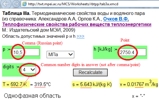

One more aspect of this problem.
We use not point but comma as decimal separator.
Users of my Reference book based on Mathcad Server can use point or comma.
And second - we can point not number of digits after point but common number of digits (as in Mathcad PM)!
Calculation properties of water/steam as function of pressure and specific enthalpy:
