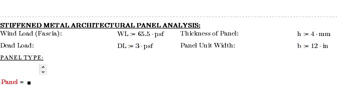

I have Mathcad 15 installed on a Windows 7 computer. Everything works fine except when I want to create a scriptable object (or web control). If I open a file that had scriptable objects in them they do not work...they appear with only small arrows. See attached.

I also have Mathcad 15 and a Windows 7 computer, and I have been having the same problem with the scriptable objects not working.
I followed MichaelH's recommendation and I registered all of the components (the .mcm files) and that appeared to fix the problem. However, anytime I restart my computer, the registration is lost and I have to re-register all of the components in order to get the scriptable components to work. How can I get this solution to work permanently even after a computer re-start?

Do you have administrator rights on the PC? Even if you do, you should right click on mcmreg.exe and select "run as administrator". That might fix it.
I think you only need to register the .mcm files for the specific language.
Jul 14, 2014 2:19 PM UTC
It appears that using the right click "run as administrator" option fixes the problem. I have restarted my computer a couple of times now and I no longer need to re-register the components each time.
