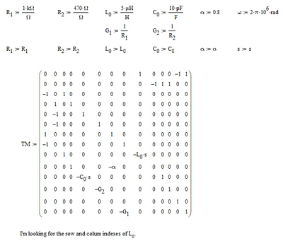

I'm looking for a little program that receives as parameters only a square matrix of alphanumeric elements and a symbolic element to search in it. The program must return the row and column indices of the element searched. Is anyone able to make it? It seems simple to me. I thank very much whoever wants to do it.

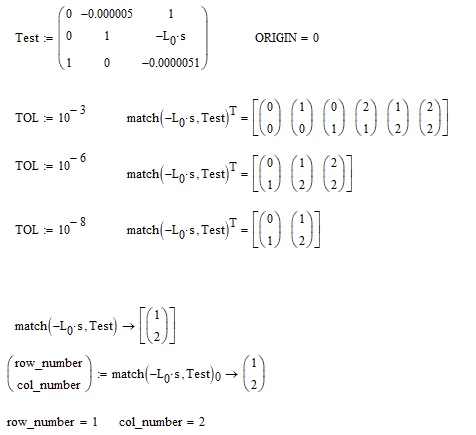

The numerics can not distinguish between -L.0*s and -0.000005
So a numerically evaluated "match" command will give you the position of both and also, depending on the setting of the system variable TOL even others which are "close" enough.
A symbolically evaluated "match" will give you the result you probably are looking for.
And, no, you can't look for just L.0, you have to use the full exact expression.

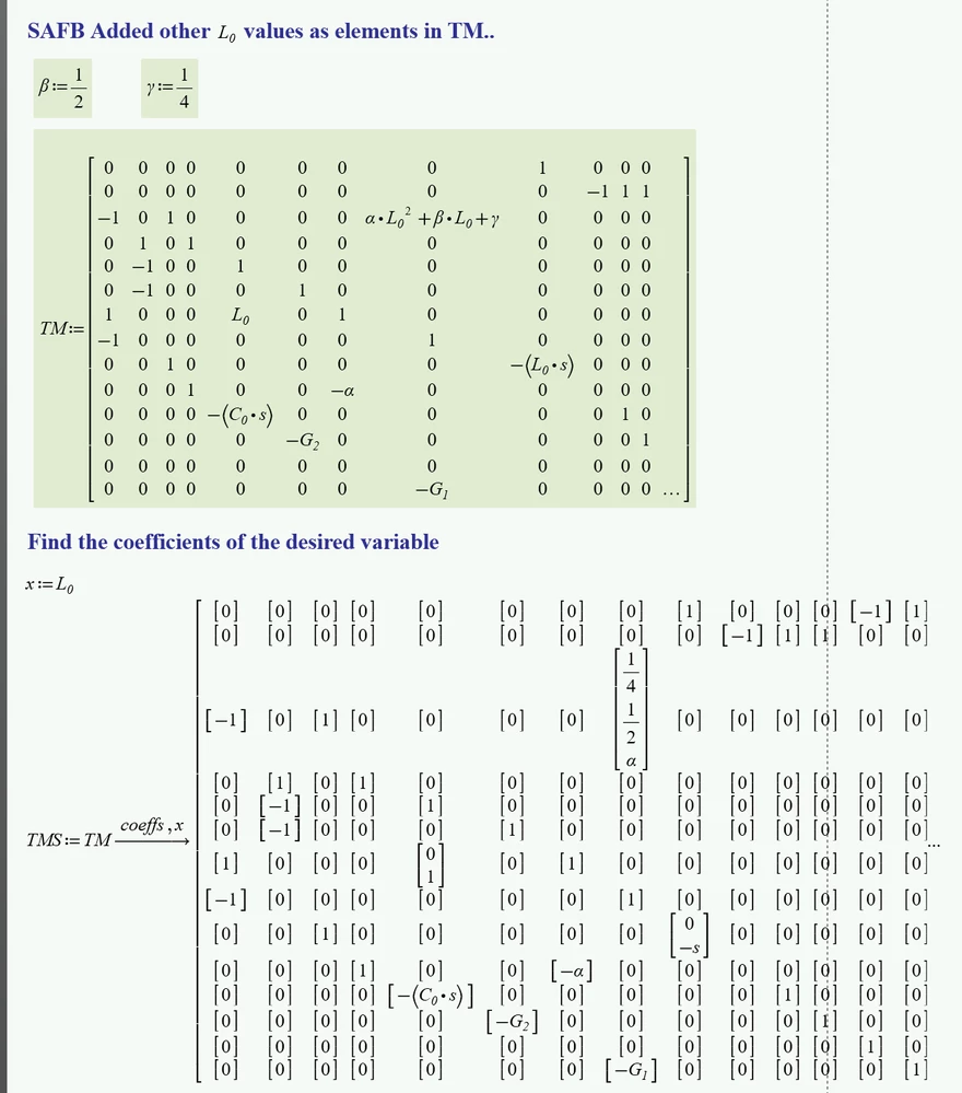

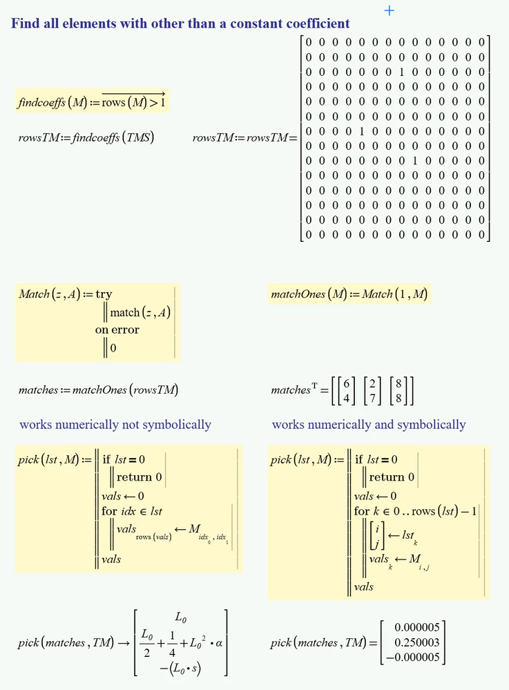

Argh, me hearty! I'm in full on pirate mode, today, and 'tis capturing your worksheet I being!
A random thought was making its merry way through the aether and got tangled up in my skull.  Poor thing.  However, whilst it was there it wondered what would happen if I looked for coefficients of the desired variable.  Sooo, ....

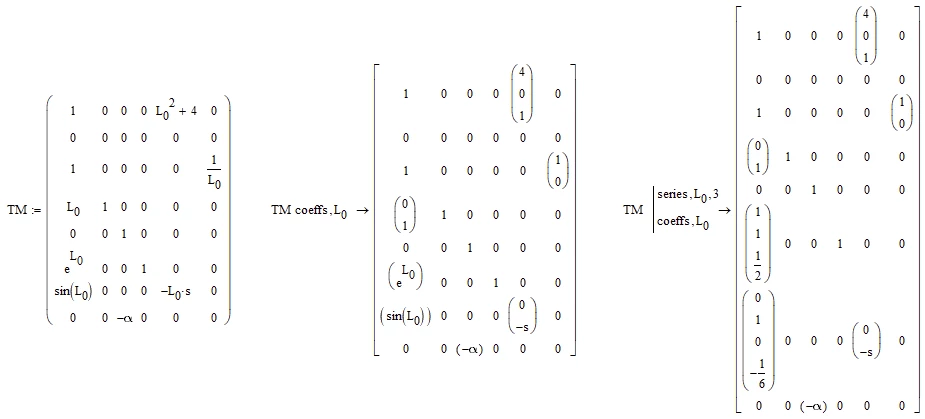

Congratulations on your pirate genes and the 'random thought' in your head. That really is a very clever approach!
Due to the nature of "coeffs" it will work pretty well as long as the variable is in a polynomial term. It will not find the position if its inside a function like sin or exp as then coeffs returns just a 1x1 matrix.
maybe if we combine it with "series" ....
It fails if L.0^2 is replaced by L.0^3 because of the modifier "3" in "coeffs".
I also came across an effect with "coeffs" which I was not aware of and which puzzled me at first - I seem to have completely forgotten about the additional "degree" modifier 🙂
