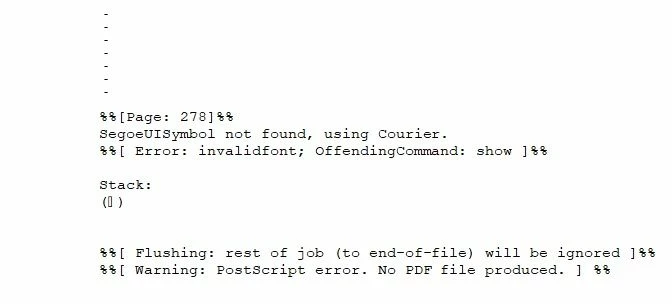

Hello everyone,
When I start the print preview of a Mathcad 15 worksheet and I try to print it in pdf format, I receive this message:
Is it possible to determine the character that generates the error and the non-production of the pdf file?
This problem has happened to me on other occasions in the past. I ran the search excluding parts of the worksheet at each Print Preview. But it takes too much time and luck. I am looking for a faster way.
Thank you very much.

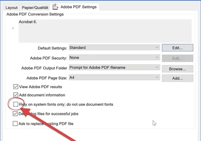

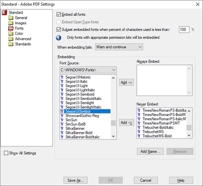

As already suggested in the other other thread, I guess you should uncheck "Rely on system fonts only" in the properties menu as already suggested by Luc. It worked for me and I could print your file. But on the other hand I never had problems by just using the print preview as you wrote - I only saw a similar error message like the one you mentioned when I tried to actually print (create a pdf) the file.
Unchecking this options allowed me to create the pdf with AdobePDF.

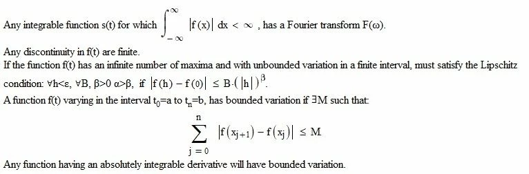

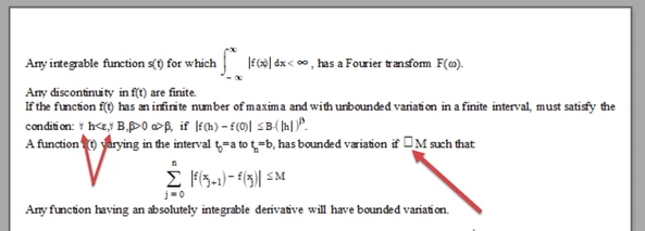

The print preview had problems with the display of some characters (either ugly looking or replaced by a rectangle):
But the pdf created after printed did not suffer from those problems, even though the fonts looked a bit different from those used in MC and the preview:
The text looks a bit condensed with a to small character spacing.

September 20, 2021
Open the Mathcad .xmcd file in a plain text editor (Notepad) and search for the string "Segoe". If it is in a piece of text you should have the location there. If Segoe is used in a UserType, you should search for occurrences of that UserType, or simply change the font for that UserType in Mathcad.

September 20, 2021
That's not the one. This appears to be in a picture. Or do you have an .xmcdz file instead of .xmcd.?
Search further..
I expect it to be between { and } , or after a "Font" item.

September 22, 2021

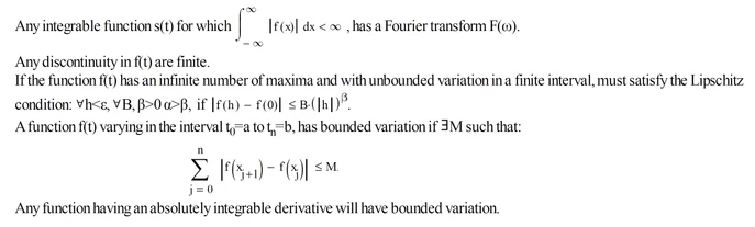

I finally found where the problem lies: it is made up of several lines of text with formulas inserted. What is the source of the non-production of the pdf file? I attach the file (it is a part of an appendix):
September 22, 2021
I assume that when you print this sheet 'Special.xmcd' you get the (same) error message.
I've looked through it and to my surprise found no occurrence of
  family="Segoe
In fact it doesn't even contain "Segoe". So something weird is happening.
On closer inspection of the sheet, my hunch is that the problem lies with the backwards E symbol that precedes "M such that". But that's just a hunch, based on the fact that it is the one character that doesn't look the same in the .xmcd file as compared to your screenshot. On the other side the sheet is small enough that you could try what happens if you take that symbol out and print to pdf...

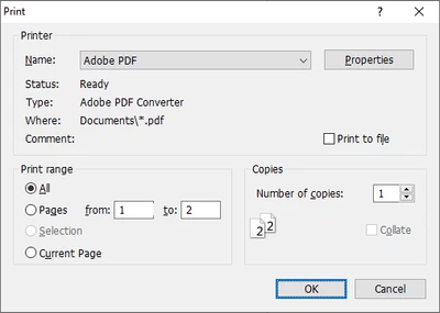

I'm also assuming that you are using the Adobe PDF printer, because looking at that driver I find:

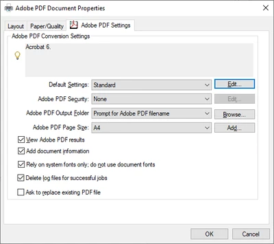

This is the interface. Now select 'Properties', to get:
(I wonder what effect (un-)ticking "Rely on system fonts..." may have for your case.)
And if you click on Edit (next to Default settings), you get:
There's the font SegoeUISymbol. It is not listed in either of the embed options.
Here I wonder what would happen if you set SegoeUISymbol to be either Always, or Never embedded.

Interesting, Luc.
The character ∀ is the "For All" character (Unicode U+2200).  It is not present in Times New Roman in Character Map (it is present in Mathcad UniMath Prime, though).   When I pasted it from the xmcd file into an Express 7 Text Box, it changed font to SegoeUI.  However, it appears correctly when I change the font to Times New Roman.
There is a Latin Capital Letter Turned A character (U+2C6F) in Times New Roman that looks like a For All - Ɐ
-MFra-21-Topaz IIAuthor
September 22, 2021
the pdf is correct. A thousand thanks.
