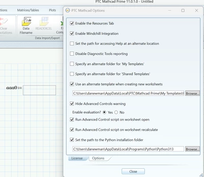

Did you set the options here?
(The last one)

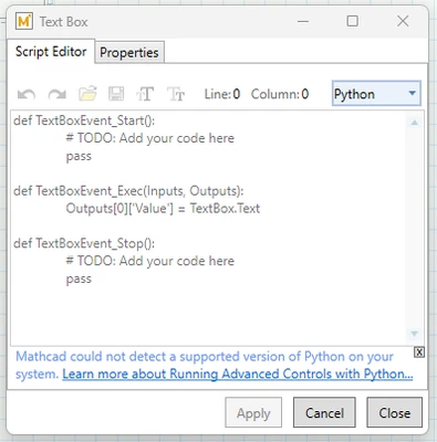

However, I am met with the following error in the advanced controls dialogue box.

Does the path to your Python installation show up in the options as shown in the screenshot from @DJNewman  ?
