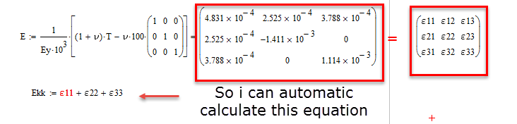

Set definition for matrix components
I'm trying to define each result of my matrix, i guess it isn't complicate but I didn't find anything about it.

Two options:
MJG1-VisitorAnswer
May 11, 2016
Two options:
23-Emerald V
May 11, 2016
If you just want to sum the diagonal, then one way of doing it is to extract the diagonal and sum it
Alternatively, you could simply take the trace:
