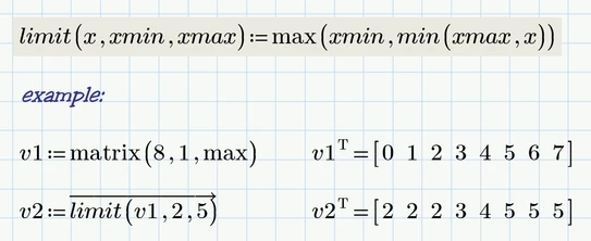

In case you need it more often to limit a value or a vector of values between two limits, you may use a small utility function.

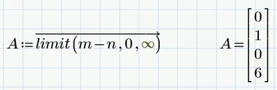

In your case you have to use vectorization and use the limits zero and infinity.
In case you use units, don't forget to apply the appropriate units to the limits as well (even if its infinity).

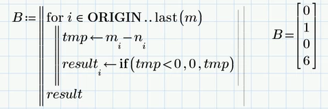

Of course you always can use programming (even thought it may be considered overkill here

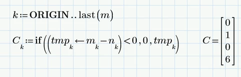

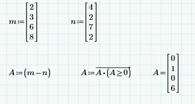

Jul 30, 2025 6:14 PM UTC
Here's one way:
