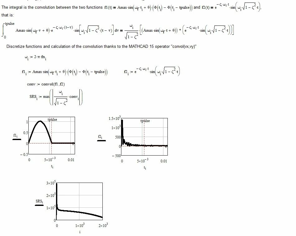

March 1, 2019
Hi JXB,
My interpretation of your problem is this:
March 1, 2019
Hi MF
I believe the interpretation is correct. It's the response of a 1 DoF subjected to an acceleration (ab(t)). I am using a half sine pulse as I am checking something  (trying to !) with a back to basic kind of approach. I want to plot different pulse duration ultimately.
Attached an update based on Fred's correction. Still dealing with your suggestion/check

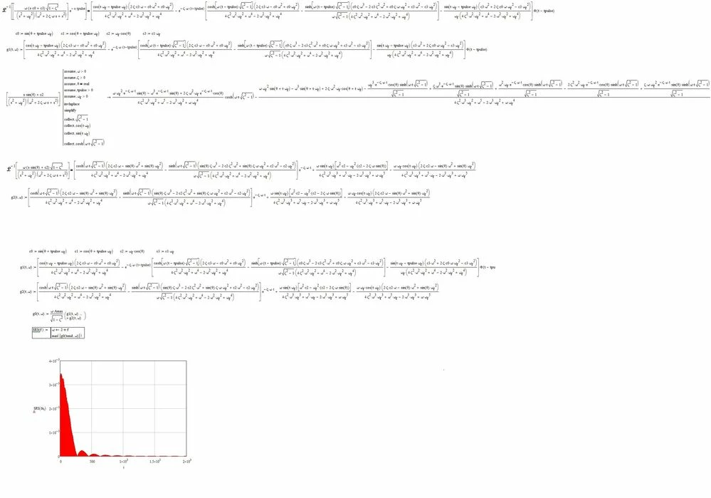

March 2, 2019
my analytical solution:
March 5, 2019
MF
Unfortunately I can only clicked one 'accept solution'. I would have accepted your effort too If I could. I have looked at the kindly provided step-by-step example and learnt a lot. Thanks a lot
