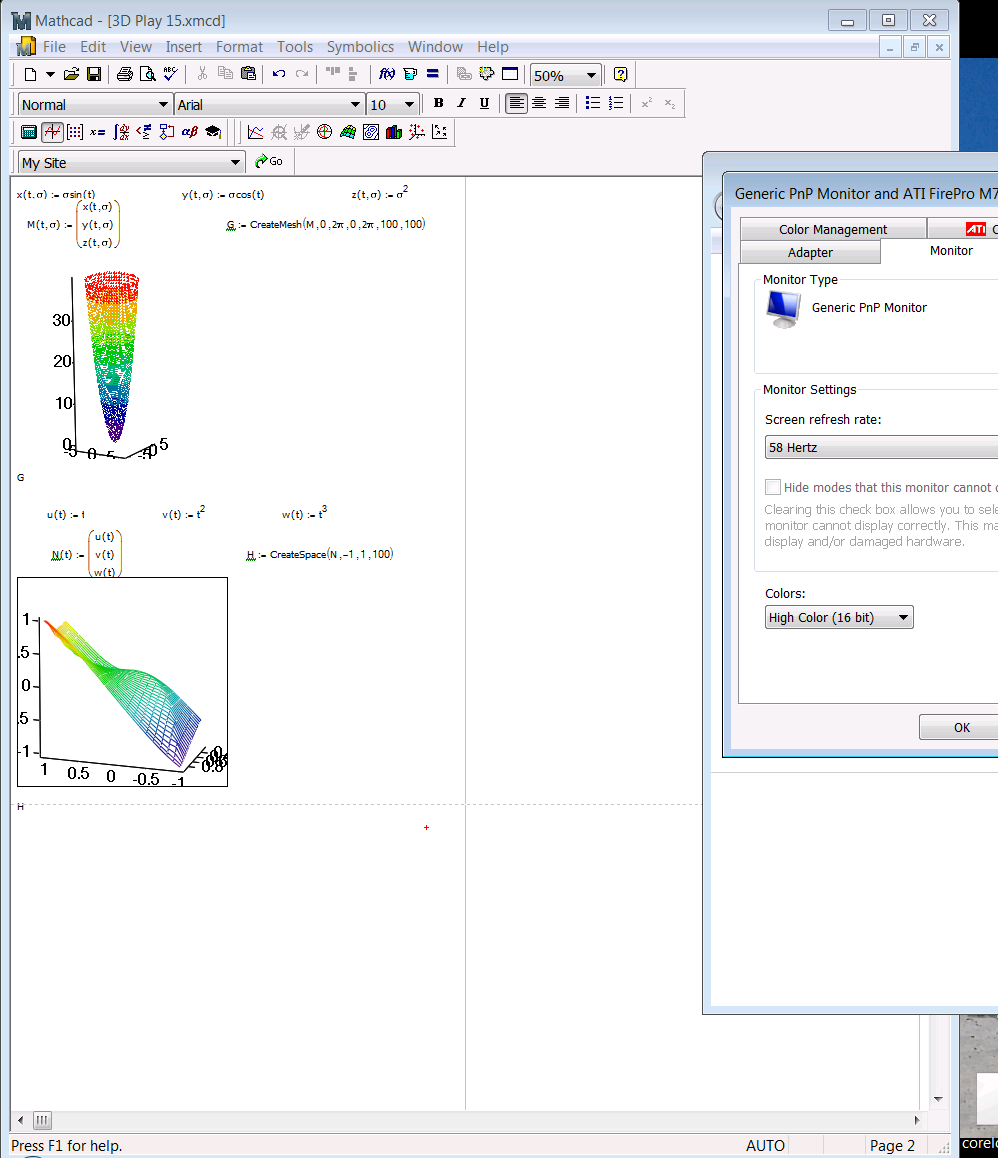

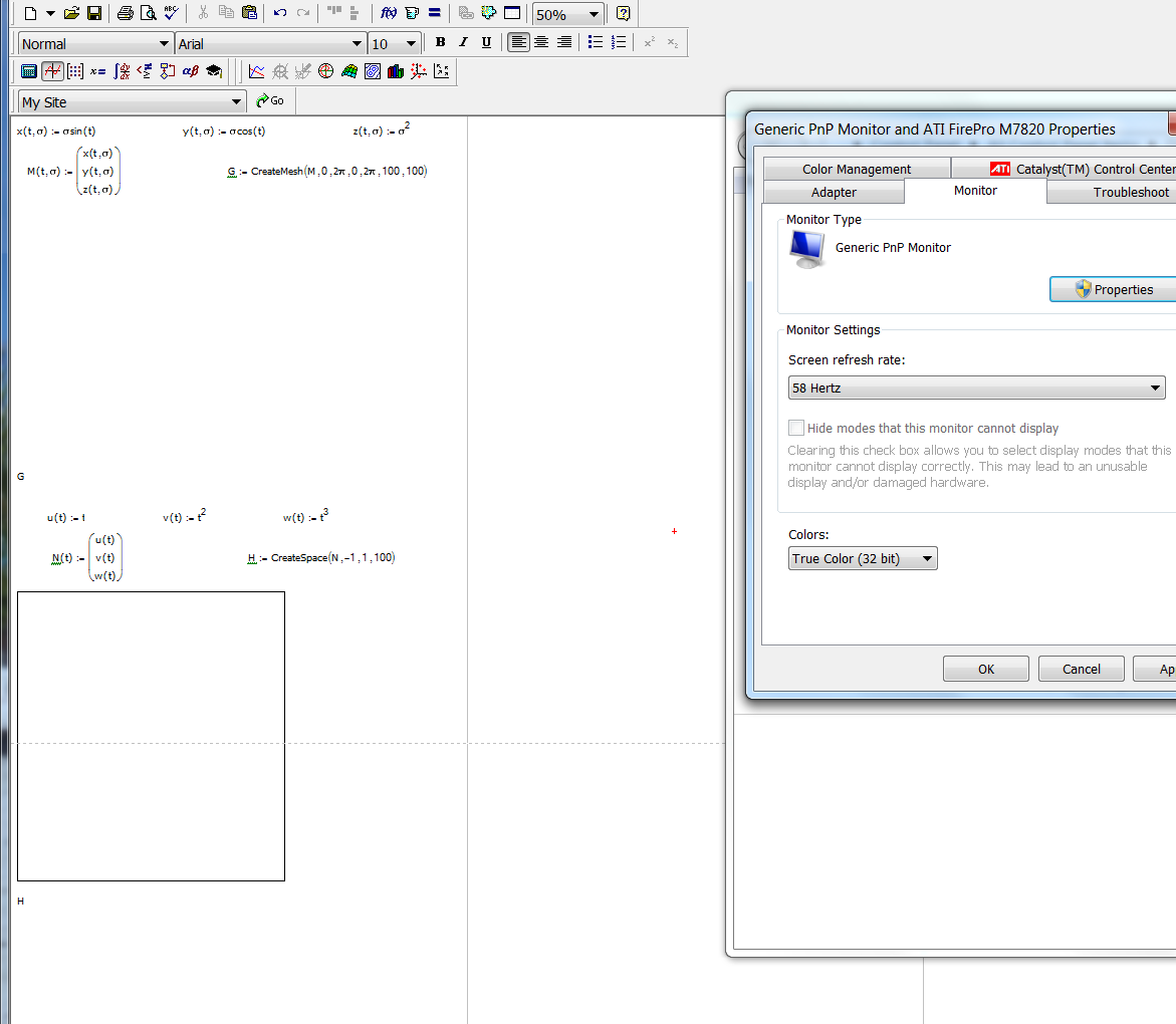

It might be a problem with the monitor set-up,  I took the following snips from the same laptop just set either for 16bit or 32bit colour resolution.
regards
   Andy
