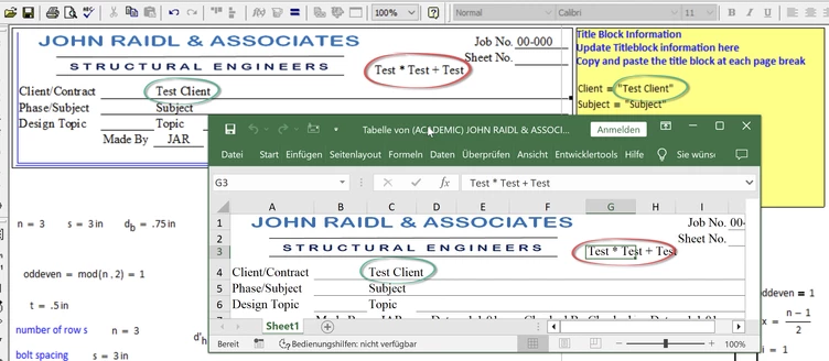

In the attached mathcad 15 worksheet the following error message is seen when double clicking the header area.  This area is an excel spreadsheet. The header is not accepting input from the form in the shaded box to the right.  I have used this header for years and now all of a sudden it has stopped working.  Can anyone please help me get this back and running again.

Actually I did nothing to your file. I opened it, double clicked the header (the Excel component). Excel would open and I edited the cell which looks shaded (it seems not to be the  "shaded box" you were talking about). I closed Excel and the change shows up, as it should be.
Then I changed a value of the global assignments in the yellow highlighted Mathcad text region and the change was immediately shown in the header. So all seemed to work OK and I did not expect that just saving the worksheet would solve any problem for you.

I did not experience any problems by double clicking the Header and editing that shaded box:
Or does "shaded box" mean the text region with the global assignments which is highlighted in yellow? Anyway, I also had no troubles changing the definitions there, too.

Wow you got it to work.  How?  Did you do something to the excel file?
I downloaded your MathCad file and it work perfectly.  But I could not open the excel file to edit out the Text*Text+Text.  I have found that any excel objects or excel components must be saved with a name for MathCad to find it again to edit it if needed.  Would you be so kind and send the excel file you edited so I can associate it with my MathCad 15 files.  Also, I want to edit out Text*Text+Text.
So I never used an external Excel file explicitly.
I deleted the test*test text now and attach that file. I also saved the Excel sheet and attach it here, but it should not be necessary that you do anything with it as its already embedded in the Mathcad worksheet anyway.
