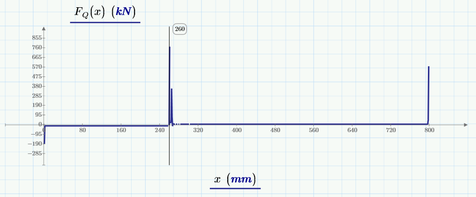

I'm trying to plot a Shear Force-Diagramm, but it fails at its graphical representation.

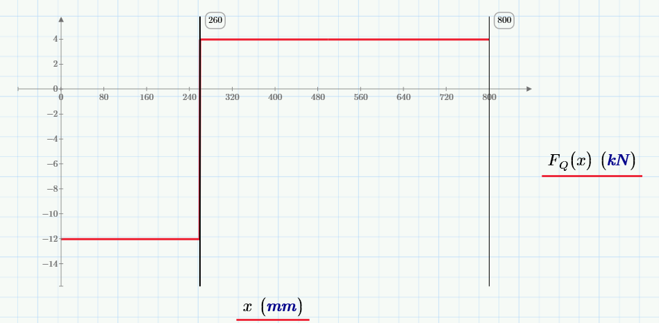

Normally it should displayed like this:
...but it is like this (see attachment):
Can somebody help me?
Thanks, Volker
Best answer by Fred_Kohlhepp
The sheet calculates the end reactions Fa and Fb, whether correctly or not I haven't tried to determine.
His solution method is to solve the differential equation for deflection from both sides, which is valid (and impressive.)  He then creates a deflection function by patching these two solutions together and takes the double derivative to get moment; again correctly.  To get shear he takes the derivative of moment, which works everywhere except at the ends of the beam and where the two solutions patch together, where the derivative fluctuates wildly.
Mathcad scales the shear graph to show all of it's reported values, so it shows the wildly incorrect fluctuations.  If we rescale the shear graph to reasonable limits and ignore the wild excursions it should make sense.

Something is wrong, even here ...

Your plot of shear force (F_Q) is seeing large oscillations because there are discontinuities in moment that aren't easily seen in the graph.  Try limiting your F_Q graph to ±20 kN, see the result.

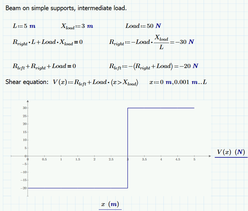

Since you have expressions for end reactions, you could solve this problem "upside down."

I was just showing that if you knew the end reactions you could do the problem the way we were taught in school.   (How you got those values is still a mystery to me!.)
