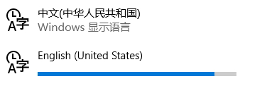

Shift+space key conflict with Windows 10 system input method editor when edit table in Chinese Simplified version Operation system.
problem:
I want to insert a column in table, when i press Shift+space key, table doesn't has any change, but Windows 10 system input method editor change from half characters to full characters.
Like the picture below :
problem solution:
install a new English language to system, when you want to add a new column to table, change the language from local language to English.
Request:
Could PTC MathCAD engineering team change the hot key "shift+space" to others or add switch options?

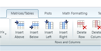

Best answer by LucMeekes
Considering the rate at which PTC implements features, you better get used to using the ribbon buttons for inserting rows and columns:
LucMeekes23-Emerald IVAnswer
March 19, 2017
March 19, 2017
Thank you, that is the only solution which is faster and better than add a new language in my post.
