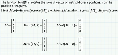

Hey, I liked to know how to shift the values at matrix by a certain value like this.
I have script in MathCad and matrix with hundreds values, and I need it to work automaticly. Thanks for help.
9 replies
April 7, 2021
April 7, 2021
Thanks a lot, it works, you are very kind.

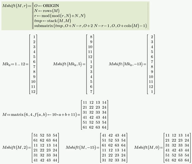

Here are my 2 cents
In contrary to Luc's "Mrot", my "Mshift" uses programming and therefore does not work in the limited Prime Express version. Also notice that Mrot and Mshift rotate/shift in different directions.
Doubling the data by stacking the matrix on top of itself is bold and may be considered inefficient, but this should not be a problem with matrices of just a few hundreds of rows 😉

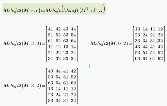

You may also use the same function to shift both rows and columns:
P6 worksheet attached

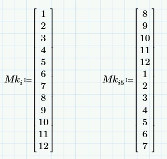

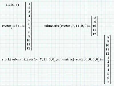

It can be with built in functions:

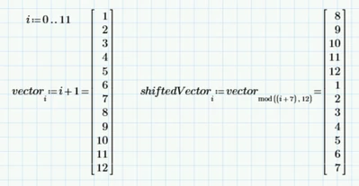

Or just by mangling with indices as follows:
