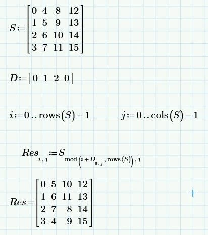

terryhendicott
Jun 18, 2022 10:28 AM UTC
Like this:-
Cheers
Terry

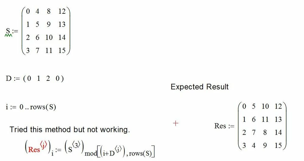

Jun 20, 2022 4:30 AM UTC
Hi, this method is not working for -ve values and floating values in 'D', Pse suggest
Eg: D=(0 1 -2 0)
Eg: D=(0 1.5 -2 0)
terryhendicott
Jun 20, 2022 5:24 AM UTC
Can you please provide an original "S" matrix and a Resulting matrix "Res" when you use a negative whole number in "D"?  I imagine this means a rotation of "S" values downwards in that column?  Can do this.
Can you please provide an original "S" matrix and a Resulting matrix "Res" when you use a floating value in "D"?  Not sure what this means?
Cheers
Terry

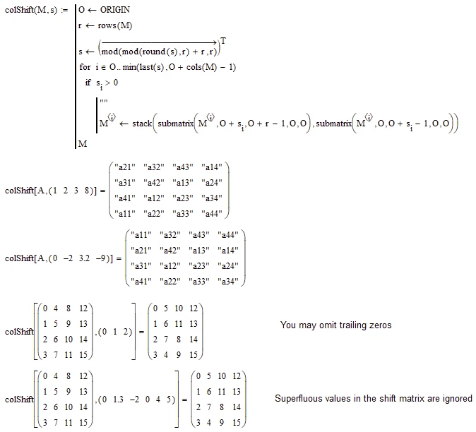

Jun 20, 2022 12:19 PM UTC
Her are my 2 cents
