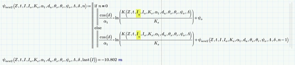

I am trying to work with my final solution but Mathcad is saying the variable is undefined even though it's being defined earlier. I have attached the file. Any help will be really appreciated.

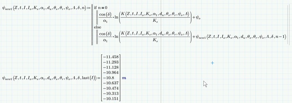

Is one of the following two function what you are looking for?
or

It's not alpha.1, but psi.ini that is undefined.
Mathcad was never superb at locating exact positions of errors.

Define psi.ini, or take it out of the function, if you don't need it, but I guess you have it in because it serves a purpose. Maybe you are mistaken and meant psi.0 ....?
One thing that will help you, is if you take the immediate evaluation off of the end of the definition.
Just define the psi.new function (in terms of K() and the rest), but do NOT put an equals sign at the end.
See if that goes without error. If there are errors in there, solve those first. Then you can evaluate the function.
