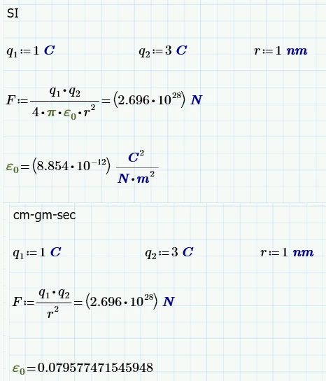

SI and cm-gm-sec - problem with units

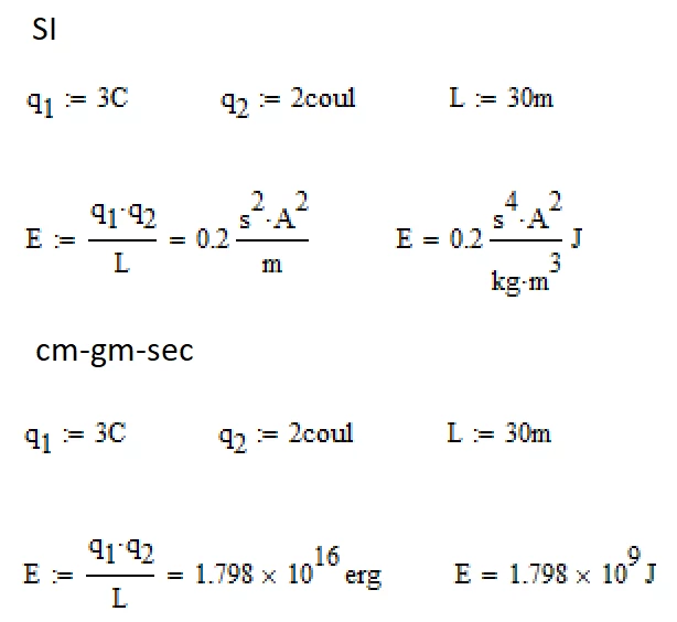

I cannot get J or erg in SI. No problem in cm-gm-sec units system. Same with Prime! Why?
February 21, 2018
No error in Mathcad and Mathcad Prime!
CGS:  coul^2/m = J.  SI : coul^2/m not equal J.

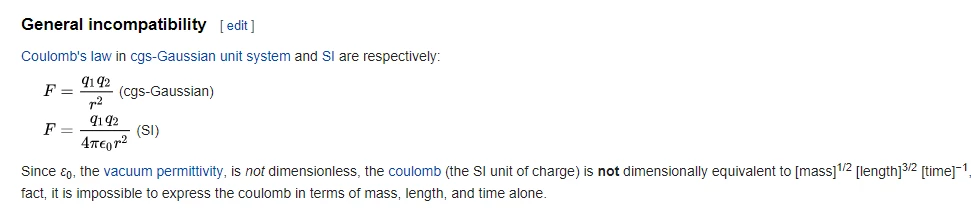

The answer is here:
https://en.wikipedia.org/wiki/Statcoulomb

The answer is here:
