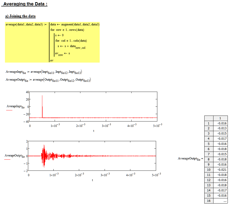

Best way?  Depends upon how generalized you wish to make the worksheet (eg, how many data sets you want to analyze).  Assuming a one-off, this is a simple method:
Stuart

If you want to average N signals just add them, and divide the result by N. Or is there something more involved about what you want to do?

I suspect, given that the original message mentioned the spectrum, Sabah may want to average the FFTs rather than the average the signals and then take the FFT.

I assumed he already had the spectra, because he only asked about averaging, not how to get spectra from a time domain signal

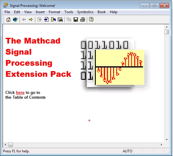

Hi Sabah,
You will also be useful to see a built Mathcad package extensions "Signal Processing" (in main programm menu select "Help" --> "E-books" --> "Signal Processing'').

Thank you my friends for your comments. Actually, the mean goal of my question is to get the steps that I should follow up in order to determine the average of three frequency spectrum signals in Mathcad 14. So I want to see if any one have an experience in this topic which can be helpful to me to do this process,

We need more information. Do you have the signals already in Mathcad? Do you need to read them from files? if so, what's the file format? Are the frequency axes for the three signals identical, or are there registration issues that have to be dealt with? Doing this in Mathcad is not difficult, but without more information it's hard to give you any useful advice.
Even better, can you attach a file (or files) containing the spectra? (Click on "Use advanced editor" at the top right of the edit dialog)
September 4, 2015
Hello Richard,
Thank you so much for your post. The signals are processed already inside the Mathcad and I did all operations for them (removing DC components, Zero-padding and else). The signals have the same length for both time and frequency domains. As I mentioned in my previous post I want to learn the procedure to averaging the signals in Mathcad 14 ( Mathematical expressions). Also, I have last question is the averaging can be did before and after the fft or its restricted for a certain case.
