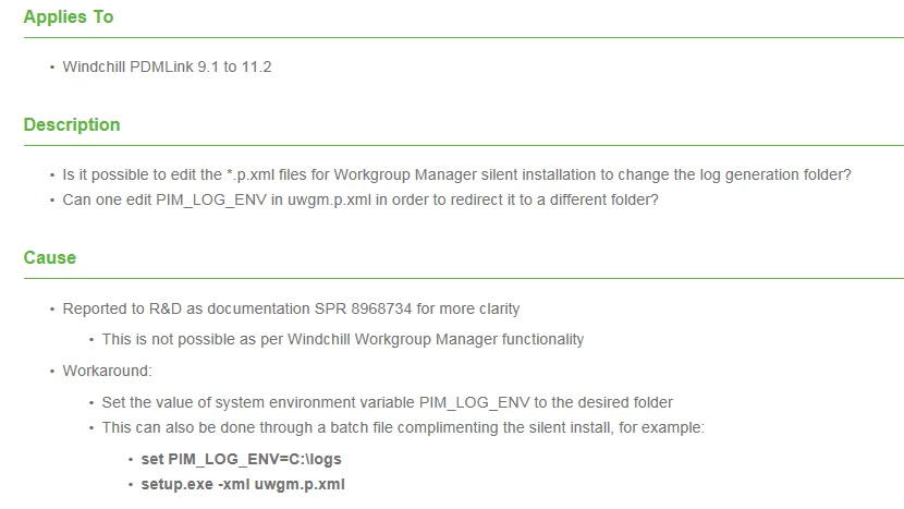

Solved using this reference:  https://www.ptc.com/en/support/article/CS311318
I hope this could solve original poster's issue also.
in a bat/cmd file:
set PIM_LOG_ENV=C:\logfolder
setup -xml mathcad.p.xml
Mathcad Prime installs successfully now, via SCCM using system account.

The key is to tell the installer where to create the "pim_prime_msi.log" which is the install that is created by the installer itself.
I solved this by simply editing the "mathcad.p.xml" file - which is the silent install answer file.

Notice the RED text above - this is what you need to edit so that the "SYSTEM ACCOUNT" (which is - by default - what SCCM uses to install software) can write to.  That user path above cannot be written to, by anyone other than the users admin account (admin_JoeBlow). Not even by the system account can write to that folder.
OK so in our company we have a location that our software deployment logs are written to.  This location is generic and you can create it anywhere you like.  Example: C:\PrimeLogs, C:\Logs, C:\Windows\Logs.  just make sure the folder you are writing to exists prior to running the installation.  You can use C:\Windows\temp if you want.
