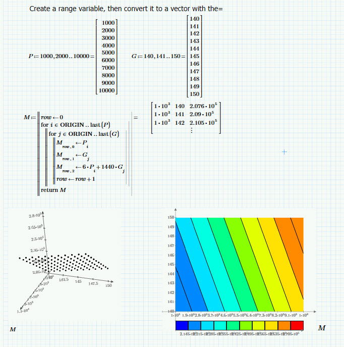

Perhaps so?
November 10, 2016
You just need a simple program.  I think the help section should walk you through programming.
November 10, 2016
Not sure if you want just to see the points or the whole plane, so her are both and P- and G- axis are correctly scaled

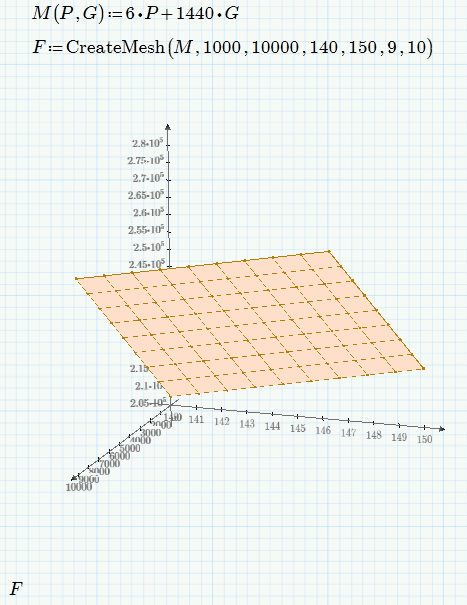

Werner had the right answer--read up on CreateMesh!
November 10, 2016

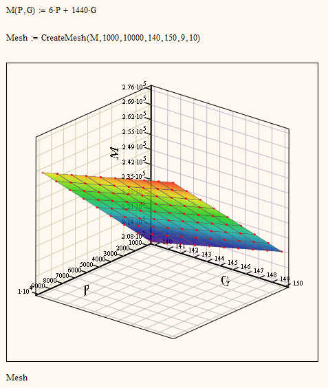

We could plot the function M directly, so CreateMesh would not be mandatory.
But its far more convenient to use CreateMesh as opposed to fumble around changing the values in the QuickPlot Data settings of the 3D-Plot format menu.
Hope you are using Mathcad 15 (or below) and not Prime as Prime's plotting capabilities are mediocre and especially Primes 3D-plots are not worth using.
PTC promised enhancements concerning plotting for Prime 4, but as far as I know now they are promising it for Version 5.
But don't get me wrong - the method using CreateMesh will work in Prime, too, and the result you get will look similar to what F.M. had shown (but with correctly scaled axis). Formatting options are very limited, though.

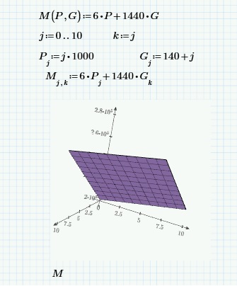

EDIT: Here is a Prime version. No colormap, no transparency, no way to format the points and lines in different colors and thicknesses, no grid in the coordinate planes, no axis names, ...
