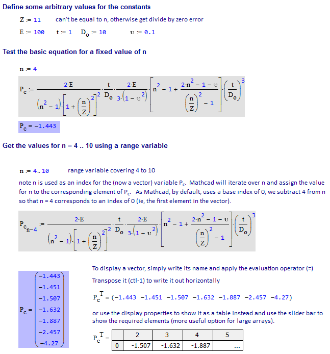

I have (what I think) is a simple mathcad problem. I only have very basis knowledge in mathcad. Not sure if I put this post in the correct discussion board
I need to solve the equation below with n=[4......10]. The range, n ,may variy from time to time so next time it could be n=[5.......25]. I have set it up and I can find Pc by just entering e.x n=6 but I would be nice to have a automatic iteration process.
I want Pc to return values for:
Pc[n=4] = ?
Pc[n=5] = ?
Pc[n=10] = ?
How can i set this up properly in mathcad. I have version 15. Is there a simple way? Keep in mind that I am a very basic user of mathcad

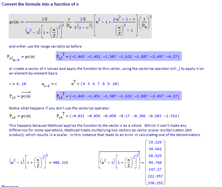

If you convert your expression to a function
Instead of
      Pc :=
Write Pc(n):=
Then Mathcad will evaluate Pc(2)= to be the value if n were 2,
     and Pc(3)=   will evaluate for n = 3,
And so on.
September 7, 2016
Hi Thomas,
see picture:
September 7, 2016
You need n to be a vector.  As you've currently defined it (n:=4..10), it is a range variable.  The simplest way to convert it from a range to a vector is to use an in-line evaluation:
Alternatively, you could do something like this (note that "k" is a range variable, and n is a vector):
Once you have n defined as a vector, you can enter your Pc equation exactly like you did before, except it needs a "vectorize" operator over the whole equation:

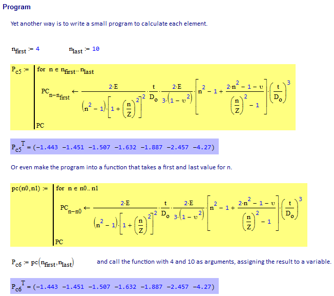

Here are a few other techniques, for tackling this kind of problem, that you might find useful as you develop your Mathcad skills.
(I've attached the worksheet that I used for this)
Range Variable​
Function
Program
Stuart
