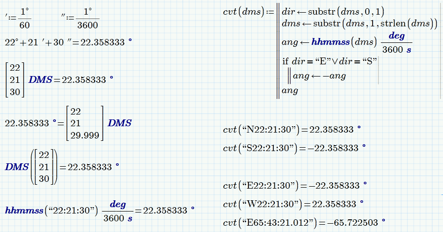

I am discovering that in Prime 3.1 there is not the possibility to manage ( or at least I have not been able ) East and North geographical coordinates
example : East01 = 12° 20' 30" , North01 = 44° 14' 28"
I found only the measure unit of " ° " but not first ' and second "
I would like work with the above mentioned coordinates and write some programs to convert them ( for example in grade sessadecimal ) or use to determine direction ( from East01,North01 to East02,North02 ) ; this second case is very frequent for the calculation of the navigation routes
I am waiting to know the state of the art on this matter ; possible or not with Mathcad Prime 3.1 ;

Maybe this will help you: Astronomical Formulas.
It was written for Mathcad 2001, so it should open in Mathcad 15 (which you should have, if you have a full license of Prime 3.1).
23-Emerald V
January 1, 2017
Note that, while you can do:
in Prime, to actually work with the ' and " symbols is quite cumbersome.

I don't understand your answer. You asked that you did not find ' and " and Luc showed you a way to implement them (as they are not yet implemented in Prime).
And Longitude and Latitude ARE angular values, what else? And 22°21'30" = 22,3583333°, no matter if North, South, East or West!
Here are a few examples of how you could use Lucs suggestion or the built-in DMS function.
You may even write your own conversion routine, maybe using the data format you would have to provide for the built.in hhmmss function.
You will have to decide which data format for your coordinates you would like to use for your further calculations and then write the appropriate conversion and other functions you need.

Prime 3.0 has a DMS unit:
January 3, 2017
Yes, and it can also be used the other way round, either in postfix notation or in usual function notation.
