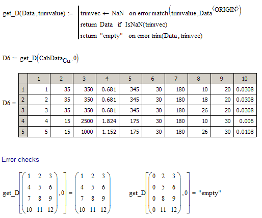

Attachments describe my issue.  Goal of program is to extract all relevant rows from a larger matrix
CabDataCu for further analysis. The program is set to test for "0" in column 1 of CabDataCu and if
not "0" extracts the row.   Programs works properly to ignore matrix rows below 5 and extracts 1-5.
The problem that befuddles me now is that it misses, i.e. does not ignore or jump over matrix Row
4 with a "0" in the first column.  I have tried several variants of the program statements and all have
ended up with same result.  Any ideas?

You're using the same variable, i, for the row index of both the source and result matrices.  When the program gets to the 5th row and sees relevant data, it stores that data in the 5th row of the result matrix.  If you want the 5th row of the source matrix to be stored in the 4th row of the result matrix, you need to use a different row index variable for the source and result matrices.

As Mark already said you need a separate row counter for your result matrix.
Maybe like this:
Here is a different approach:
Here is an approach using routines from the Data Analysis Extension Pack
and her the same but with an error check so the routine does not fail if no row has to be trimmed.
Werner

BTW, the last approach wrongly returns the full original matrix in the case when the first column contains only zeros. It should return something like NaN in that case.
But I guess that will be no problem for Paul as this case is quite unlikely.
Anyway ->
There is still one drawback and thats a limitation of match (and also of Match with "eq"). Any value in the range triggervalue +- TOL will trigger the row trimming. So with the default TOL=10^-3 a value of 0.001 or -0.0001 in the first column will get the row eliminated.
Also possibly no problem for this application as I just see integers here.
