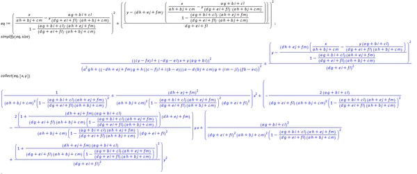

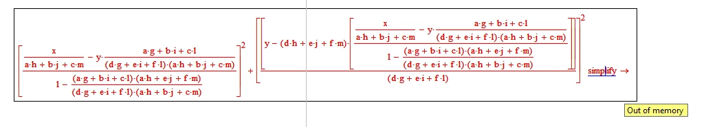

I would like to simplify the expression in the attached worksheet (and image), however I am faced with the "out of memory" error, which occurs after about 30minutes of processing. I have 16GB ram, i7-4790 CPU at 3.6Ghz, 64 bit Windows 10, MathCAD version 15.
Please note that all letters are variables, and I intend for none of them to hold any particular value. To avoid confusing MathCAD I have tried replacing e,i, and j by different letters, but to no avail.
I predict that the result will be in numerator/denominator form, with numerator having a sum of  x^2*y^2, x^2, y^2, xy, and the denomiator having neither x nor y.

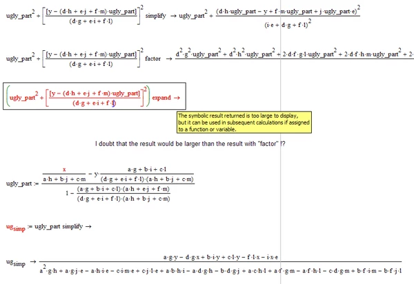

I noticed that ther is one big expression occurs twice in your term and so I thought that we could have more success with some kind of substitutiuon. I guess without luck (didn't wait for the last expression to finish simplfying).
I think the painful truth is that Mathcads symbolics simply isn't good enough.
Furthermore I won't expect a short result expression - it rather would be quite large, I guess.
-MFra-

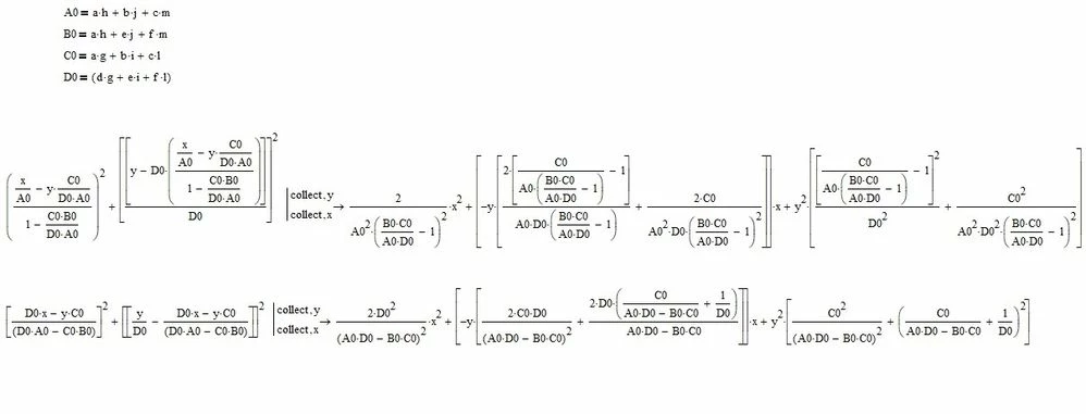

a possible simplification could be the following:
JBird1-VisitorAuthor
Thank you both for your input.
Essentially I need to equate the co-efficients of x.x y.y and x.y to another equation, so F.M's simplification may hold high value.
