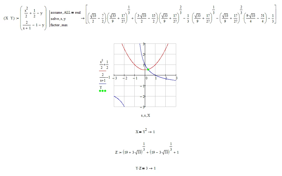

Hello Everyone.
From :
But :
To : So now the question is : " How to simplify A ? "
Thanks in advance for your time and help.
Best Regards.
Loi

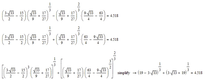

The two expressions definitely are equivalent.
With a little help even Mathcad can show this:
The numerical evaluations are just done to check if I made any typing errors 😉
But its interesting that MC11 returns 0 when we compare the expressions while MC15 returns 1.
It may have to do with the principal value of the third root ? Not sure, though.
Are the results the same in MC11 ?

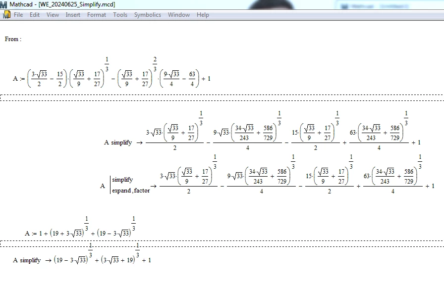

You have to face the truth - the symbolics in MC15 seems not to be capable enough to do the simplification you want to see.
Neither is the symbolics in Prime 10 - see here:
Only way to achieve the result you are looking for in MC15 seems to be as in attached, but I am sure you won't like it 🙂
Attached Sheet is in MC11 format, maybe @LucMeekes  would like to give it a try with MC11/Maple.

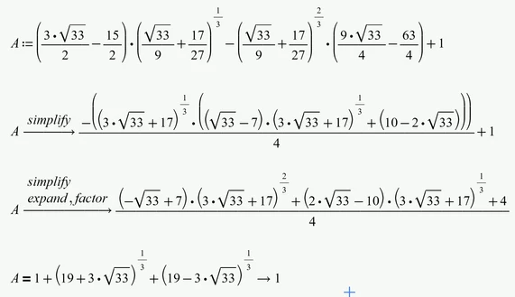

   I guess my MC15's symbolic engine is less powerful than your .mcd file. But I guess I should like your own mcd. file :

Thank you very much. I suspected one of the many identities on the topic of "Tribonacci". OEIS is full of them. But now the solution depends on the elaborate system of equations in x and y. How did you come up with this approach?
BTW
In the graph in MC14, the green point for Y is not shown.
