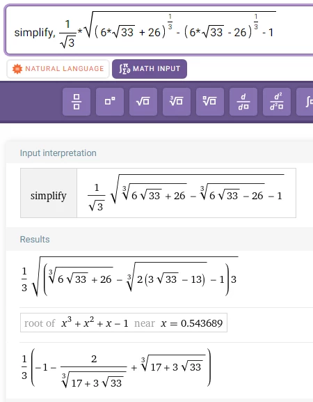

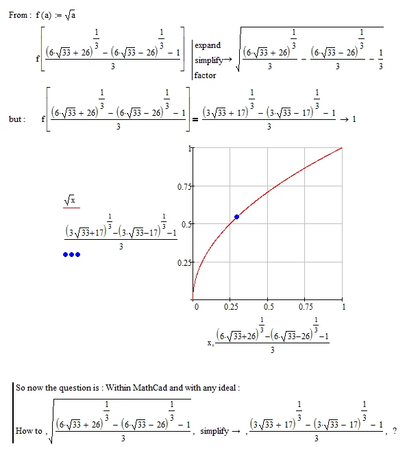

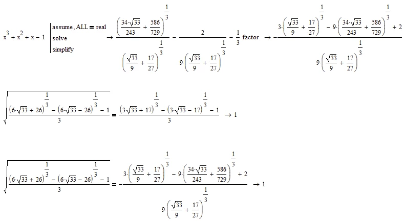

Hello Everyone.
From :
To : How to simplify the above ?
Thanks in advance for your time and help.
Best Regards.
Loi
