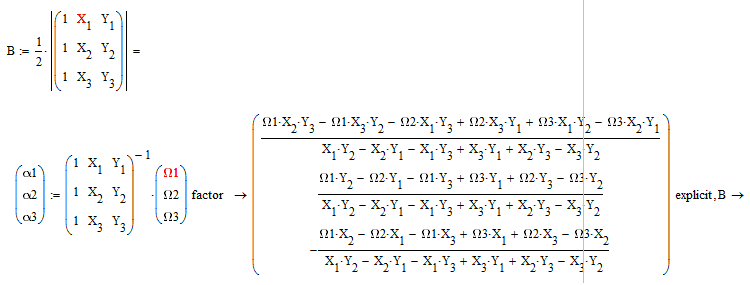

Hi. I have the problem presented in the attachement. I need to replace the value of the determinant of the second expression with B, to make it simpler. I've tried with "explicit, B" but it doesen't work. How do i do that? Thank you

For reasons unknown to us he wants Mathcad to display something like
which I guess is demanding too much.
7 replies

Can't see your file at the moment but the mathematical term for replacement is substitution. Mathcad has that built in. Use the 'substitute' symbolic keyword with argument {determinant}=B.

Here is the whole content of his file:
He has alreaday asked the same question here: http://communities.ptc.com/message/261653#261653

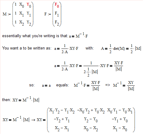

23-Emerald V
It is possible, if you tell Mathcad what you want it to give you. With:MatrixAlgebra.png
