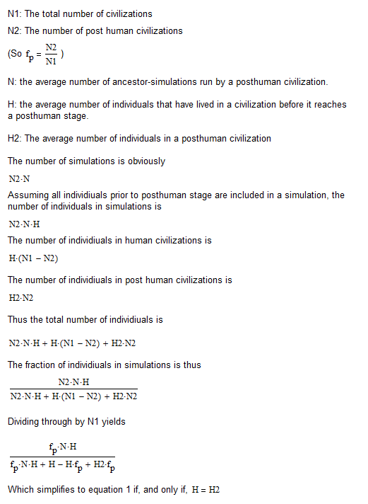

Could someone please explain how equation 1 is arrived at, in the attached Mathcad file. The Simulation Hypothesis posits that we are living in a computer simulation writen by our posthuman (ie. in the far future) selves. The statistical analysis is based on the following (taken from the Abstract of the paper in the Reference, at the end of the Mathcad document):

Hello Richard,
Many thanks for your clear and concise answer. I will use it to write a Mathcad document which explains the math in the "are you living in a computer simulation?" paper, for the math challenged like myself. Perhaps I will post the result here.
Peter
September 17, 2016
But why should H=H2? The author does not address this (at least, I didn't find it, but I also did not read the paper very carefully)
