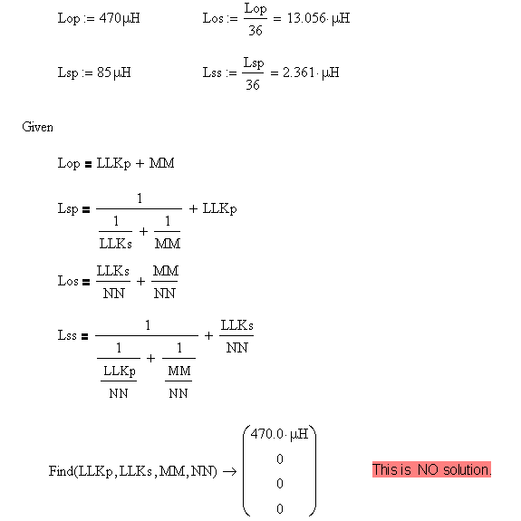

In Mathcad15 , the solution of the following simulataneous equation is  correct ?
Because the solution of MM,NN,LLKs is zero. If so, zero division is in equation.
One solution is also attached.
Please advise me.
<< one solution of above equation>>

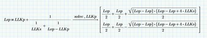

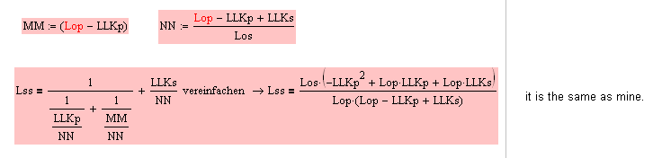

Hi Sato,
according to your questions:
1. Equation Lss: use definition markers (see point three) and you get the same result as mine:
revise your sheet and you can calculate all without memory problems.
2. LLKp1 and LLKp2: they are a result of a quadratic-equation, normally one solution (LLKp1 or LLKp2) is valid.
LLKp can be LLKp1 or LLKp2.
see:
I named this two solutions LLKp1 and LLKp2:
3. rearrange your worksheet. Use for definitions the ":=" symbol, not the boolean "=". and then you can simplify your expressions and get the same result as mine.
4. After you rearranged your worksheet, you should calculate it completely.

Please attach your Worksheet:
use "advanced Editor" and then you can attach the file.
Btw: you are using a solve block, but there are missing guess-Values for solving your equation system.
best regards, Volker

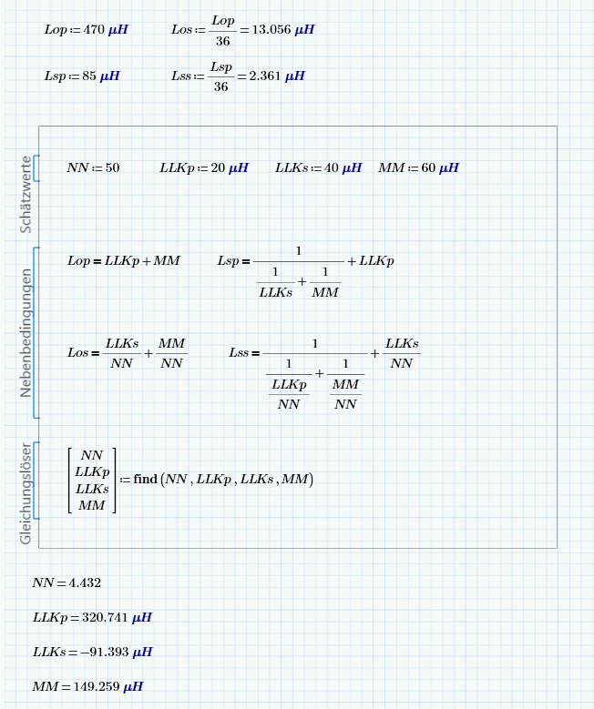

I tryed to solve it with MathCad Prime4.0
There is no stable solution, you should rearrange your equation system to get a constant result, which means: wheather you choose any guess values you'll get the same results.

June 7, 2017
I tryed an analytical solution and that shows, there is no solution.
See attached File please.
The equations, derivated from the cirquit diagramm: It seems to be ok.
Volker

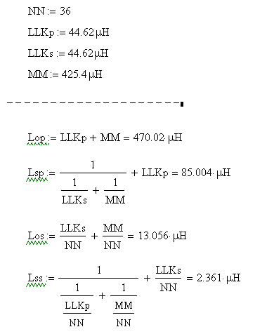

June 8, 2017
Thanks for your reply.
I have some question.
1. Lss (equation 2)
    I calculate Lss by MATHCAD15. The result non-equal to your solution.
2.LLKp1,LLKp2
  LLKp1 is not equal LLKp2.
  If so ,we have two Lss.
3.If my simaltaneous equations has no solution, why Mathcad output no ERROR ?
4. I attached the result above 1 in MATHCAD15.
  And in this file, I calculate analytically LLKp,LLKs , Mathcad output the error "out of memory".
Sato

Hi Sato,
see:
