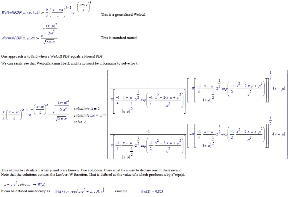

Try your luck with this:
Maybe you can evaulate W(x) symbolically and then display the result numerically. (Mathcad 11 can)
